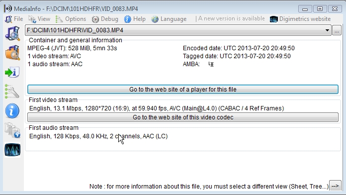

    hi. Here's a screen shot of what Mediainfo says about the file, or should i use g-spot for better details? Is there some sort of audio codec that i could use with virtualdub that would read the audio better? Thank you!
  4. Do you have aacacm installed ?
    http://gral.y0.pl/~fcchandler/
    http://gral.y0.pl/~fcchandler/AACACM/index.html
    How are you opening the video in vdub ? something like ffinputdriver or directshow input driver ?
