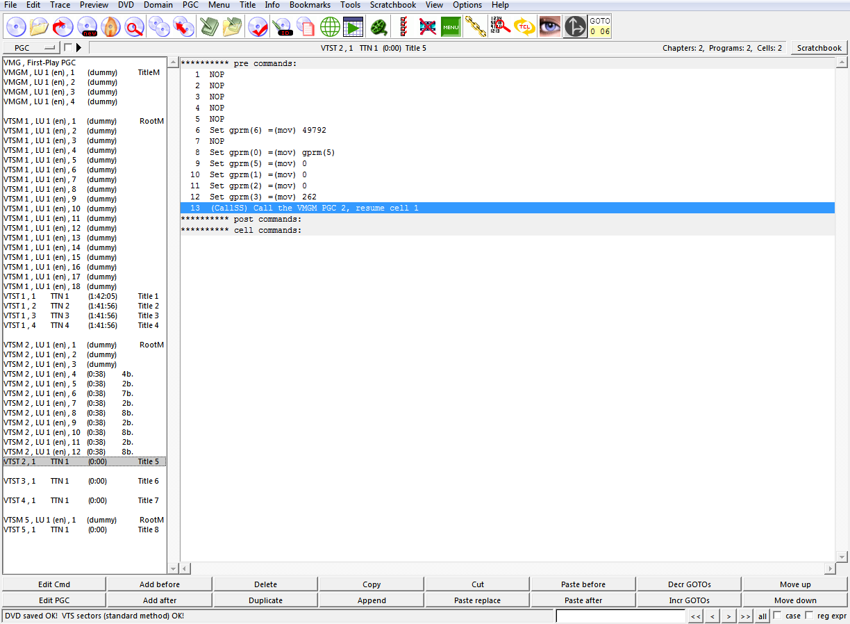

    Hi, I got this DVD that I want to edit and "clean up". First problem i got is when i delete a button when I delete a button all funktions gets messed up on the other buttons that I want to keep. It is like all funktions moves one step, if PLAY is before BACK TO MENU, then BACK TO MENU becomes PLAY and so on. How do i change the buttons funktion and how can I see the buttons funktion (or the code/command) in PgcEdit? (I dont want to hide the button, need to be deleted).
    The other problem I got is that I want to clean up or delete unwanted VTS and I don't really know how. I use Vobblanker to remove crap I don't want like Extras and Trailers. Then I run it in PgcEdit to remove some other useless stuff. When thats done It always leavs empty files. How do I remove them in PgcEdit so I only the IFO+bup file and the vob files DVD VTS_01_1.ifo, BUP and VTS_01_1.vob to VTS_01_6.vob and the VIDEO_TS.IFO (Movie and Menu). Can't just delete them cus then the DVD wont work.
    Screenshot of VTS that I don't want: https://forum.videohelp.com/images/imgfiles/0wcsDPe.png
    (VTST2, VTST3, VTST4 ... and so on)

    I guess you know that's why it's recommended to hide a button rather than completely remove it? Maybe you want to redo menu commands, but I don't. Sounds like a stupid 'scene' rule.
    DVD->Delete Last VTS in DVD. But be careful. You have to make sure the commands for the VTS you're keeping don't go into the VTS's you're removing. Just do a trace through all the stuff you're keeping.
