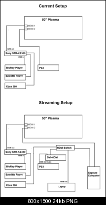

  14. This is my current setup, and the proposed streaming setup.....drawn crudely with as much artistic skill as I will ever display.

    Your schematic (beautifully drawn I may add ) looks ok. What is the idea behind having the hdmi out from the laptop to the hdmi switch ? Just to have the laptop screen show up on the plasma ?

    the HDMI out from the laptop is just if I want to play a PC game and stream it as well. that won't always be connected, I don't do much PC gaming anymore.
    I can't output the video from the encoding computer to the TV because there are only two HDMI ports, so would require more/different switching hardware, and would be pointless because if i'm playing PS3, I can't play a game AND display the video from the encoding computer.....also that video wouldn't be needed as its just encoding and streaming.
