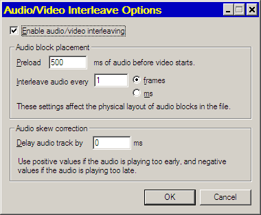

    Originally Posted by Locke View Post
    Is there any way to alter the interleave pattern and preload?
    Yes$S, just use a decent AVI multiplexer, such as VirtualDub or AVI-Mux GUI
    Image Attached Images
  18. Member
    Dec 2011
    England
    I tried that, even with 1 frame selected, it was interleaving every 45ms (1.12 frames), so I forced it to interleave every 40ms, and still no difference until I removed the preload as well... but still the same effect from Youtube.

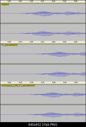

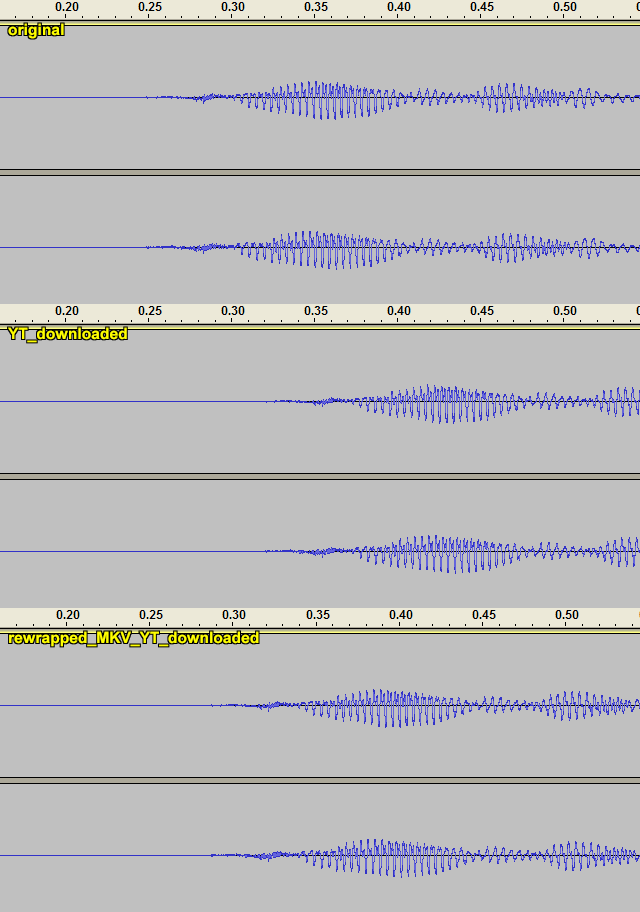

  21. Originally Posted by Locke View Post
    I tried the MKV thing as well, and even that made no difference...
    It makes a difference of about 20ms .
    40ms is 1 frame for 25fps video
    But typical human might not be able to detect 20-40ms differences (of course it varies widely) .

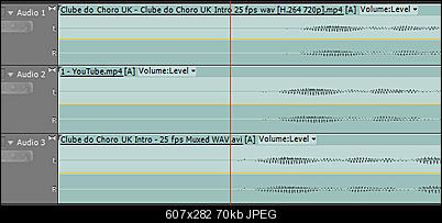

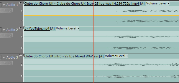

  26. Originally Posted by Locke View Post
    I did check the waveforms, I uploaded the MKV, downloaded it again, did likewise with the AVI and... exactly the same, not even 1/2 frame of difference, unfortunately. They are both offset from the original file by exactly 1 frame.
    Edit: Wait a second... where did you get the 1.75 frames out figure from? Aah ok, I think we have the same offset in our MKVs, but for some reason you got a larger offset in your AVI test, that's really weird.
    The 1.75 is a calculation from your YT video ; 70ms/40ms per frame = 1.75 frames - that was an approximation just looking at the audio waveform in audacity . I'm looking at the difference between the beginning of the waveform compared to the original's waveform . e.g. if the original waveform starts at 0.25 seconds, and your youtube version starts at 0.32 seconds, the difference is 0.07seconds, or 70ms.
    Different decoders might compensate slightly (e.g. it might be a few ms different in flash, vs . premiere, vs. audacity vs. some other program or media player) , but there is definitely a difference, and the relative trend will still be there (ie YT version slightly worse the the re-wrapped MKV YT version)
    Here is the file I re-wrapped (I used an older mkvmerge version v5.4, but I doubt it makes a difference - I have no idea why you're getting different results, but you can find old versions here https://www.videohelp.com/tools/MKVtoolnix/old-versions#download )
    "1.mkv"
    Here is the MKV rewrapped download from YT (using IDM)
    "1 - YouTube.mp4"
    Same trend in premiere
    track 1 is your YT version or "Clube do Choro UK - Clube do Choro UK Intro 25 fps wav [H.264 720p].mp4"
    track 2 is the MKV rewrapped YT download or "1 - YouTube.mp4"
    track 3 is the original or "Clube do Choro UK Intro - 25 fps Muxed WAV.avi"

  29. Originally Posted by Locke View Post
    That very last frame of delay... I'm beginning to think it is an unavoidable part of Youtube's conversion process at this point.
    That was pretty conclusively established in post #10.
    Lossy audio compression schemes that are based on overlapping time/frequency transforms add a small amount of padding silence to the beginning and end of each track.
