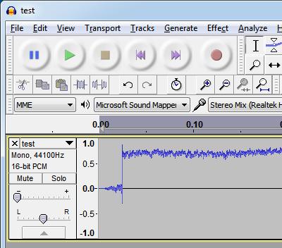

  3. The click comes from the strong DC offset when you start recording.
    Note how the average level jumps from 0 to 0.7 volts. That's probably from bad grounding somewhere. The noise may come from that too. How high is the mic gain turned up?

  6. Originally Posted by jagabo View Post
    [Attachment 18898 - Click to enlarge]
