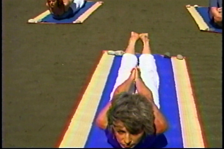

    Hello All,
    I just bought a Panasonic AG-1970 of Fleabay, and although the seller said everything is working well, I noticed something strange on videos played using it. I'm adding a sample, notice on the edged of the towel, there are "dancing lines" appearing.
    At first I believed those to be because of the interlacing, but I deinterlaced the video and they didn't go away. I also noticed them even on static scenes, with absolutely nothing moving, except the lines.
    Is the Panasonic defective? The TBC is on btw (I tried with it off, no difference, with TBC the image gets a bit darker).
    If I remember correctly, my superold JVC S3500U didn't have this behavior!
    Thanks for your help!

  3. The "dancing lines" is horizontal time base jitter. All VHS decks will exhibit this to some extent unless they have a line time base corrector (even then there will be a little residual jitter). I seem to recall the AG-1970's TBC doesn't work well. Some decks with line TBC:
    https://forum.videohelp.com/threads/230650-Confused-Why-a-VCR-with-TBC-if-separate-TBC-needed-anyway

    I think I just got a defective one, as turning on the TBC did nothing
