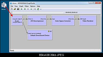

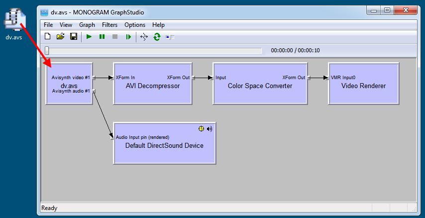

  2. Works here. I can just drag an AVS script onto GraphStudio.
    AviSource("dv.avi")
    ConvertToYV12(interlaced=true)
    Works without the ConvertToYV12 too.
  3. DECEASED
    Jun 2009
    Heaven
    Works here as well since 1975
    AVS files normally are handled by the AVI Decompressor (which is part of quartz.dll) and sometimes also require the Color Space Converter filter ( depends on the crappiness of the current video drivers, I suppose )
