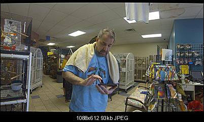

  12. Thanks for the tips. The low-end version I have does include the Deform filter, but I had no idea it could be used for this. None of the presets are anything like it. But, I can combine the available deformations to make a pretty good approximation of the un-fisheye distortion.
    Here is the original frame grab: that's me turning on the GoPro using my phone as a wi-fi remote.

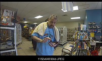

    Using the Adaptive Wide Angle filter in Photoshop, I pointed out some of the should-be straight lines in the image. It can do quite a bit of bending in complex ways to make desired lines straight and orthogonal at the expense of what lies between; but the first line or two set up the global parameters. So then I cleared that and just set a plain 6.5mm lens correction with nothing fancy:

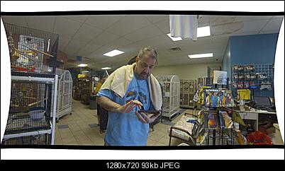

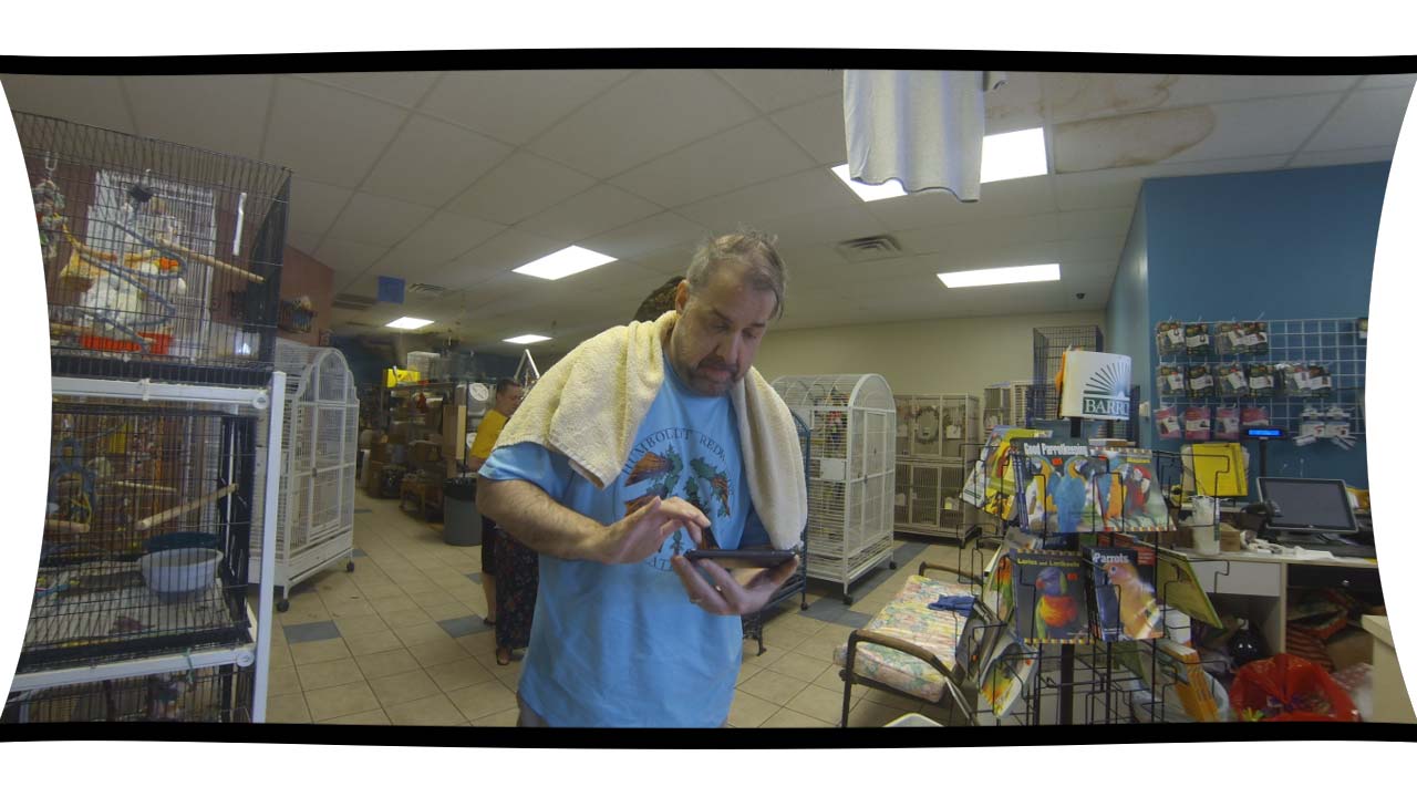

    Then, I used the Deform filter in Vegas to mimic the degree of curvature on the edges. The deformation pushes in from the edge rather than pulling out from the corners, so I then stretched the whole thing in the opposite direction. All done by eye and keeping symmetry, I got this:

    You can't see the left/right curve because it's cropped off; but you might see that the top/bottom on PS is not as simple of a curve but is more strongly curved in the center and flattens out toward the edges. I think it might be the same if the frame were square, but the Distort is based on an edge period and not the distance from the center changing along that edge; it is a very close approximation for the short edge but not on the long edge.
