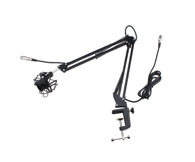

    don't use automatic level setting. set the level manually for the loudest your voice gets. maybe -10db, to allow for things like a cough to not clip. then use a compressor to level things out. the mic should be around 6 inches from your mouth, not on the other side of the keyboard. get a movable stand so the mic can be positioned directly in front of your face.
