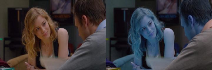

  1. I wanted to use mencoder to decode an avi file (and normally do some filtering which is not supported by ffmpeg), then pipe the output to ffmpeg to encode as prores using:
    mencoder -lavdopts threads=2 -really-quiet -of rawvideo -o - -ovc raw -demuxer lavf -vfm ffmpeg -noskip -vf scale,format=i420,scale,format=422p -nosound -mc 0 test.avi | ffmpeg -y -pix_fmt yuv422p -s 640x352 -f rawvideo -i - -threads 2 -vcodec prores_aw -profile:v 0 -f mov test.mov
    Problem is that the output is all blue, and all people look like smurfs, which normally is a good indicator that some color conversion went wrong.
    -> does any one see where I made the mistake ?

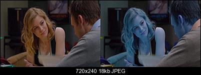

  2. Sounds like the U and V channels were reversed. Like this?
  3. yes, but why?
    should do the conversion, shouldn't it ?
  4. you can try -vf swapuv, but I would try to figure out the underlying problem first
    which filtering are you doing that is not supported by ffmpeg ?
    btw, ffmpeg added a field matcher + decimate (IVTC) , plus a bunch more things recently
  5. which filtering are you doing that is not supported by ffmpeg ?
    mainly filmdint (I also use libass, since I can't get ffmpeg to compile with it properly, due to the whole fontconfig thing )
    Didn't know about decimate.
    Thanks, swapuv does solve the problem, but why is it needed at all?
