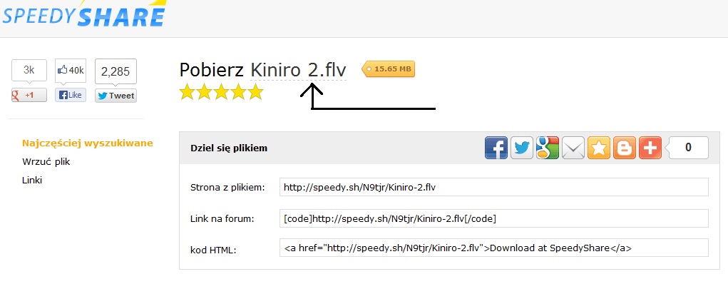

  5. Ok, so thanks to El Heggunte's method I was able to mux audio in my recent encode, but it didnt change anything for me, i couldnt open it with kmp with any sort of options changing . It played audio only. Same for MPC-HC.
    I couldn't even open it with graphstudio, as it would crash upon starting graph, just to mention it's a 1080p encode ( strangely enough i played aitsu.flv no problems whatsoever in graphstudio ). graphstudio just crashes the decoder .dll
    i can still play the only-video flv in kmp and add external audio though. or opening mp3 and flv separately in mpc also works. I have to say 1080p looked impressive for me considered 46.3 mb into 13.3 mb change.
    I also have hard time figuring out what the heck am i doing wrong with drag/drop avs script as it just won't show up or when i add it as source file it has no pins , well just 'out'. Thankfully feeding hevc encoder through lav filters from mkv still works for me, what i thought you could do too .
    that's the muxed flv with audio
    http://speedy.sh/N9tjr/Kiniro-2.flv

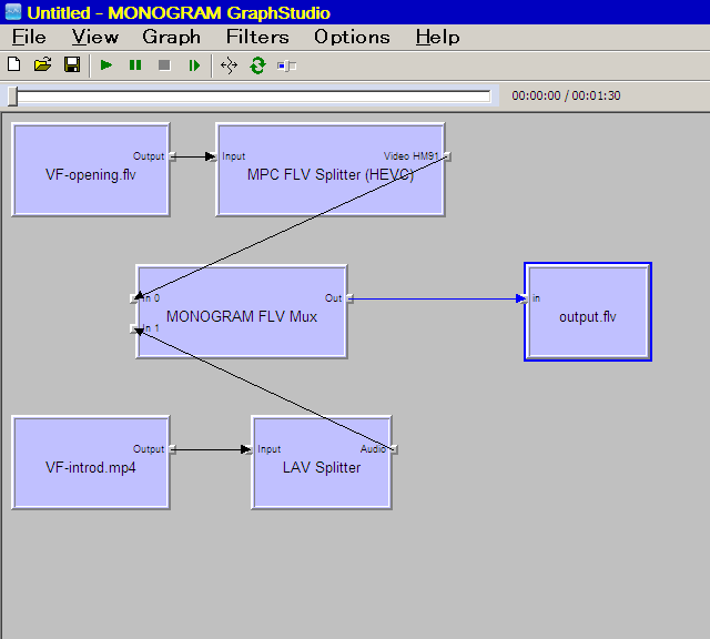

    Jun 2009
    Heaven
    Make sure the modified FLVsplitter.ax (HEVC-capable) is being used --- set its merit to preferred, OR disable the FLV demuxer in LAV Splitter, for example.

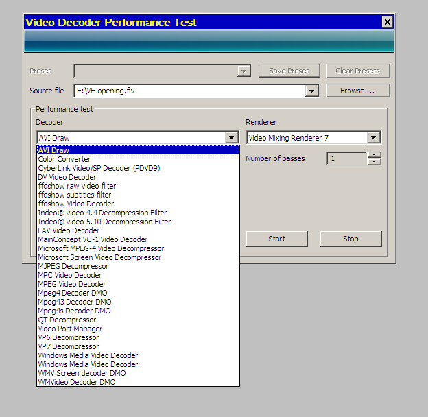

  12. DECEASED
    Jun 2009
    Heaven
    More remarks:
    1) my sample encode («Aitsu.flv») is NOT an example of "big bitrate saving". The settings I chose: preset SLOW, max IDR period = 24, QP = 24.
    2) Still haven't found a way to remux from hevc-FLV to hevc-AVI , BUT already found it's possible to go from hevc-FLV to hevc-DSM
    (for the uninformed, DSM is a container invented by Gabest, the creator of Media Player Classic).
    3) Another bug of the Lentoid Decoder: it doesn't appear on the dropdown list of the performance test applet

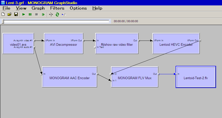

  17. DECEASED
    Jun 2009
    Heaven
    Originally Posted by El Heggunte View Post
    the FLV multiplexer would find big difficulties in dealing with a very-fast audio encode *plus* a very-slow video encode happening at the same time
    NONSENSE --- and here is the proof that I was wrong
    P.S.: Weird, in both WMP11 and Potplayer, Lentoid-Test-2.flv plays 100% fine, *but* in MPC-HC, the last video frame isn't shown

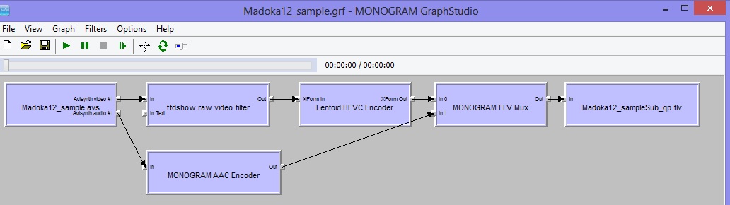

  21. Hi
    I managed to encode the flv directly with aac audio with almost exact same method and it's working perfectly with avs, I could extract and hardsub
    exactly the part of source vid i wanted right in the script.
    The thing is one simple way of doing this worked on 1080 encode i was doing recently, but
    on the other it didn't . Here's the script working fine on my 1080 encode [basically 1 line if not undot] :
    DirectShowSource("C...\[HorribleSubs] Kiniro Mosaic - 02 [1080p].mkv", fps=23.976, convertfps=false, audio=true)
    LoadPlugin("C...\MeGUI_2308_x86\tools\avisynth_plugin\UnDot.dll")
    Undot()
    Trim(30827, 32967)
    And this is what i had to do to get things working with the other vid:
    LoadPlugin("C...\MeGUI_2308_x86\tools\ffms\ffms2.dll")
    v = FFVideoSource("C...\[Meguca]_Puella_Magi_Madoka_Magica_-_12_[BD][h264-720p_AAC][DEAA7EFB].mkv", threads=1)
    a = DirectShowSource("C...\[Meguca]_Puella_Magi_Madoka_Magica_-_12_[BD][h264-720p_AAC][DEAA7EFB].mkv", fps=23.976, convertfps=false, audio=true).KillVideo()
    audiodub(v, a)
    Undot()
    LoadPlugin("C...\MeGUI_2308_x86\tools\avisynth_plugin\VSFilter.dll")
    TextSub("C...\[Meguca]_Puella_Magi_Madoka_Magica_-_12_[BD][h264-720p_AAC][DEAA7EFB]_track3_eng.ass", 1)
    Trim(12947, 13810)
    undot, trimming and the rest weren't issues as far as i checked, plus what was going on is gray screen instead of picture showing up on the latter
    encode, despite the very same thing working earlier lol .
    Also cant play muxed flvs in smplayer which has nice pic equalizer. plays audio only.
