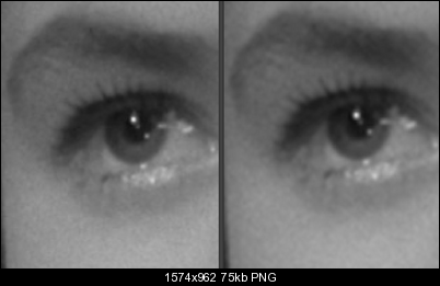

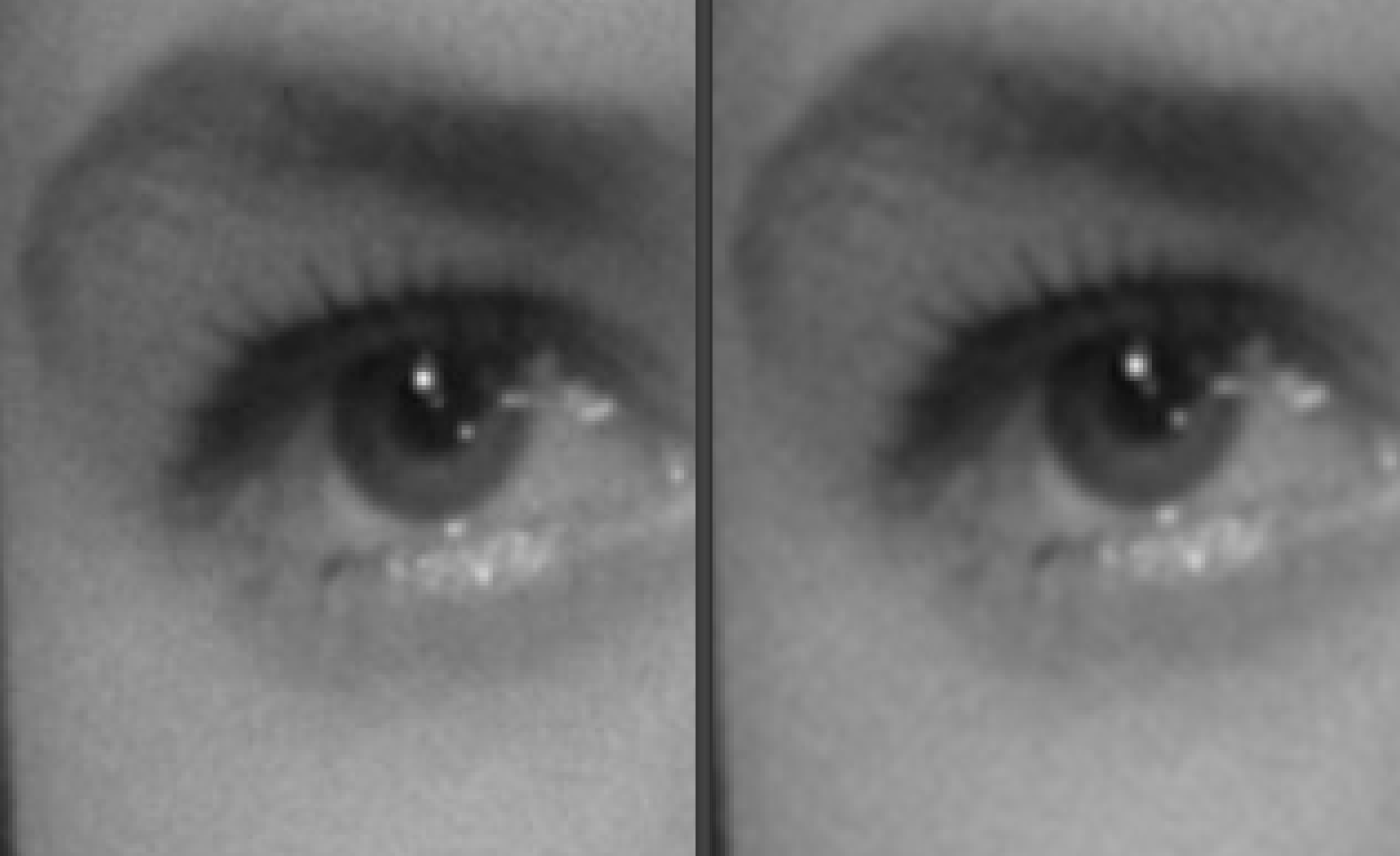

  13. What's your original source for the 3rd image? The lights reflected in her eyes suggest it's from a still shoot -- probably large format.
    And you can't see the difference here?
    How about here?

    But I'm not impressed with Casablanca. It's pretty soft and the film grain looks subdued and blotchy:
    http://www.dvdbeaver.com/film3/blu-ray_reviews56/casablanca_blu-ray_/large_orig_blu-ra..._blu-ray_5.jpg
    http://www.dvdbeaver.com/film3/blu-ray_reviews56/casablanca_blu-ray_/large_orig_blu-ra..._blu-ray_1.jpg
    this is all assuming that the Bluray screencaps were grabbed correctly and are representative of the disc content.
    Soft focus will make the image appear less crisp, but the effect is more a general mistiness/contrast reduction rather than a typical blur/optical defocus. So it's possible to still see fine detail though the haze.
