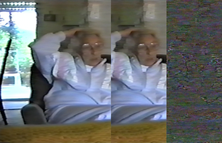

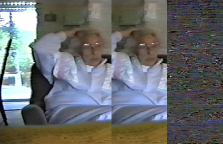

    Attached are 2 screens I made from frame 13 and 22 using video from first post.
    The columns are: Processed-Unprocessed-Difference - From a quick avisynth script I wrote to demonstrate the filters I mentioned (settings left default).
    backup images link
    https://picasaweb.google.com/109966249066847502296/AvisynthHomeVideo?authuser=0&authkey=Gv1sRgCKDor-D1iJvBiwE&feat=directlink
