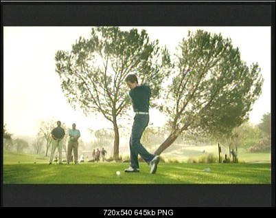

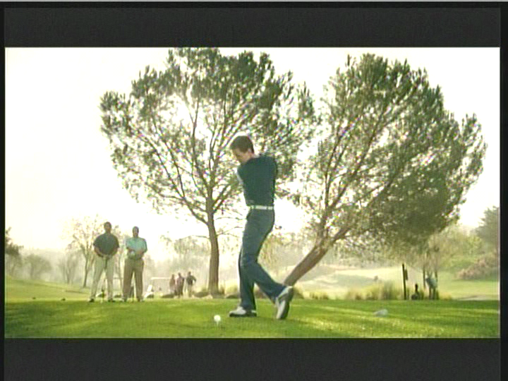

    Thanks for all the help. Now I'm starting another video edit. Mediainfo says it's 720x480 but the VLC snapshot (attached) is 720x540. How can I get rid of the big grey top and bottom bars and smaller grey outer border and make the video larger if possible?

  10. Originally Posted by jc1 View Post
    Why'd you encode as 4:3 when you already know it's 16:9? Can't you tell the golfer is too tall and slender?
    jagabo already suggested cropping away the black bars and resizing to some 1.78:1 ratio such as 854x480. You probably don't want to make an MPEG or DVD, either 4:3 or 16:9, if the ultimate goal is to upload it to YouTube.
    If your program doesn't let you crop and resize to rid yourself of the black bars and get it in the correct aspect ratio, maybe it's time to learn a different program.
  11. Post #9 is about a whole new project and capture from a different source and I copied the raw info above, so the source is 4:3 and I haven't recoded. This time it's the raw video that has black bars. I haven't started to edit it yet and want to know the best settings and resolution to use to get rid of the bars and increase the size if that can be done without losing quality. The program lets me crop and resize.
  12. Originally Posted by jc1 View Post
    You can't reencode with a lossy codec without losing some quality. The easiest way is to resize to a 4:3 frame size, crop away the black borders, then encode.

  14. Oh, I see I was wrong and apologize. I hadn't noticed you said it was a different project, and this one really is 4:3.
    The video is stored in the MPG at 720x480 but is resized for playback by VLC to 720x540, a 4:3 or 1.33:1 ratio.
    I don't use this VSDC and doubt many here do, but maybe someone can help. Anyway, in AviSynth speak, you crop:
    Crop(8,60,-12,-54)

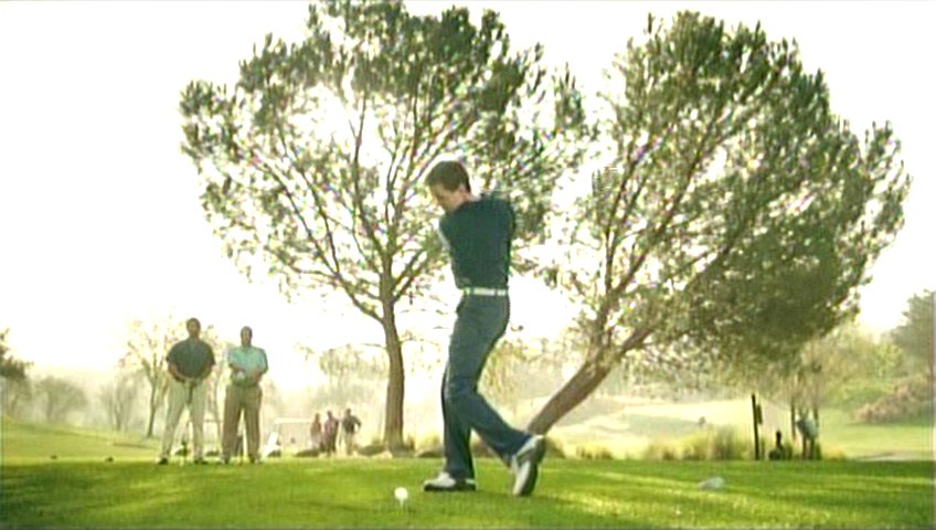

    to remove the black bars from the original 4:3 MPG. That's 8 from left, 60 from top, 12 from right, and 54 from bottom. I won't go into the blown whites which may be a result of how the picture was taken (although I doubt it). Here it is cropped and resized to 848x480 (which may not be the correct final aspect ratio):
