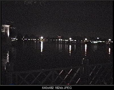

    Here's a 3 second sample of DV avi (about 11 megs) from a cam that didn't do well at night. Lots of grain/noise.
    What would you suggest as the best approach to minimizing the noise?
    https://docs.google.com/file/d/0B0zvAZXgfLgidm1QWm9sTUVueUk/edit?usp=sharing
    Thanks. Screen shot included.

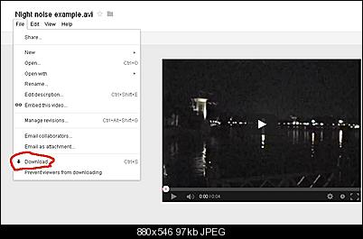

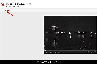

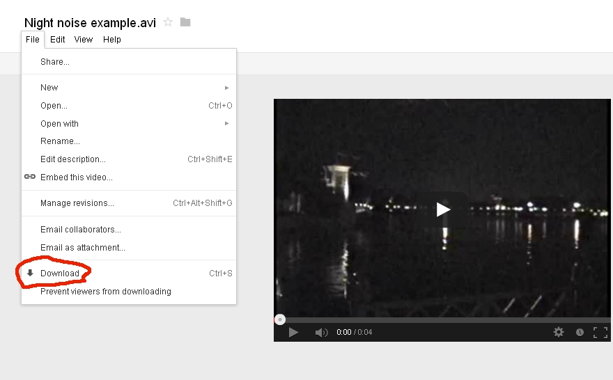

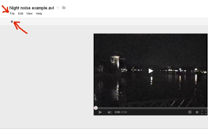

    Then perhaps you can learn to provide direct links instead of web pages that require users to search all over the place for the actual download link.
    All over the place as in just to the left and up from the player window that the link brings you to? There isn't any more direct link. That page is it.
    I would have assumed that someone who's smart enough to be savvy about video encoding and has familiarity with how things generally go on the web would recognize that the quite visible down arrow right there on the page that's linked to is the common symbol for "download" which automatically gives you a download applet.
    Of course if you'd rather do it in two clicks instead of one there's also the quite visible "file" option right above.

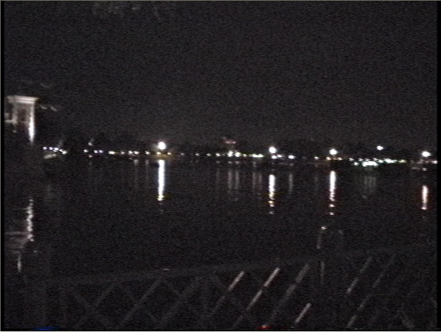

    Well here is the script I used in MeGUI:
    # Set DAR in encoder to 123 : 92. The following line is for automatic signalling
    global MeGUI_darx = 123
    global MeGUI_dary = 92
    LoadPlugin("C:\Users\ChuckD\Desktop\MeGUI_2028_x86 \tools\ffms\ffms2.dll")
    FFVideoSource("C:\Users\ChuckD\Desktop\Night noise example.avi", threads=2)
    LoadPlugin("C:\Users\ChuckD\Desktop\MeGUI_2028_x86 \tools\avisynth_plugin\TIVTC.dll")
    TFM(mode=5, PP=5, blockx=64, blocky=64, chroma=true)
    TDecimate(mode=3, hybrid=2, vfrdec=1, dupthresh=0.3, se=true, mkvout="timecodes.txt")
    crop(8, 0, -8, 0)
    #resize
    LoadPlugin("C:\Users\ChuckD\Desktop\MeGUI_2028_x86 \tools\avisynth_plugin\FluxSmooth.dll")
    FluxSmoothST(7,7) # Medium Noise
    ConvertToYV12()
    I am also using x264 10bit so dunno about banding in 8-bit
    here is a before and after shot @crf 16
    Last edited by dannyboy48888; 7th Jul 2013 at 07:34. Reason: forgot to add quality level used
