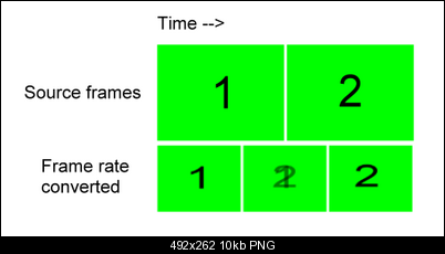

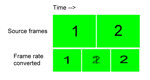

  19. Field blending is like frame blending -- except it's done of a field basis. It's often used in frame rate conversions. When the duration of a frame spans the time between two source frames the frame becomes a blend of those two source frames.
    The horizontal axis represents time. The width of the frame indicates the duration of that frame. The first frame rate converted frame started at the same time as the source frame and didn't last as long. So it is not blended, it's just a copy of source frame 1. The second converted frame spanned part of the duration of frame 1 and part of frame 2. So it is a blend of frames 1 and 2. The third converted frame spanned only a portion of the time source frame 2 is displayed so it's just a copy of frame 2.
