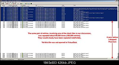

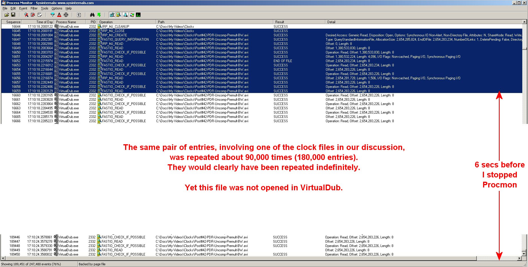

    In an attempt to isolate my VDub problem I started it, stopped events, cleared the entries and added a filter to show only Process Name = VirtualDub.exe
    I then opened an old, small AVI (nothing to do with this thread) in VirtualDub 1.9.11.
    I then started Procmon capture and quickly performed the following operations, in about 10 secs.
    In VDub I used File > Save as AVI file (F7) and then clicked Cancel in the resulting dialog. Vdub then froze as usual. I then stopped Procmon capture and used XP Task Mgr to close VDub.
    I rarely use Procmon because its results are almost entirely obscure to me. But this time I hope it might may offer some clue as to what's causing the crash. The most striking thing is that a pair of entries involving one of the 2.6 GB clock files accounted for all the activity apart from the first few seconds, presumably from when I clicked Cancel.
    I repeated it with several other old AVI files from 5 to 1 years old and from a variety of folders. All gave the same result. In one of the exercises I added another filter:
    Path = C:\Docs\My Videos\Clocks\Post#42-PDR-Uncomp-Premult-BW.avi
    and saved the Procmon log file, as both a PML and a CSV file. If you're interested they are uploaded here:
    https://dl.dropboxusercontent.com/u/4019461/VdubPuzzle-ProcmonLog2.PML
    https://dl.dropboxusercontent.com/u/4019461/VdubPuzzle-ProcmonLog2.CSV
    I'm off to get some dinner but will pursue this further.
    Needless to say any feedback would be appreciated.
    Terry, East Grinstead, UK

  20. Originally Posted by terrypin View Post
    I think that filename was the one I tried to give when saving PDR's file to'Old format' in VDub, which as you may recall crashed
    Terry, East Grinstead, UK[/QUOTE]
  21. Sorted!
    I deleted the implicated file C:\Docs\My Videos\Clocks\Post#42-PDR-Uncomp-Premult-BW.avi and for good measure renamed the \Clocks folder to \Clock Videos.
    Voila - normal operation is back.
