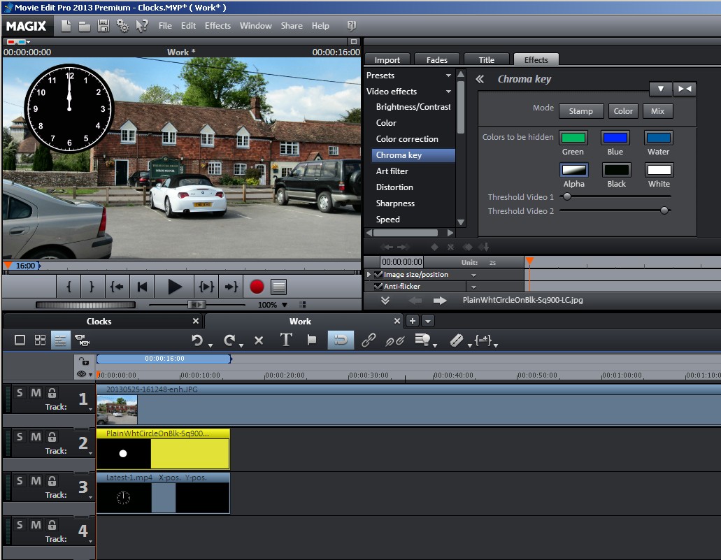

    track 1: background
    track 2: "alpha keying object" (refered to as "mask" or "luma matte" by others in this thread); - it's black and white, white is "see through" , like jagabo's picture above post#22, it's called "mask" there
    track 3: foreground (clock)
    If it's too big (covers too much of background), resize the layer => I see there is a "Movement effects: size and position" - to adjust the size & position . You might have to resize both track 2 & 3 by the same value (I don't know if MEP can "link" tracks)

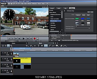

  9. Bingo - thank you, I have it working!
    I don't mind helping out making a clock video either, but you need to be more specific on the requirements, such as design , speed, frames .
    That one you sent me below looks just fine. Or a negative of it. More ambitiously maybe an actual clock like that yellowish one I found and adjusted up-thread, with its hands showing shadows. But I'm very happy to get this one working, albeit with the limitations (probably down to MEP) which I've described later.

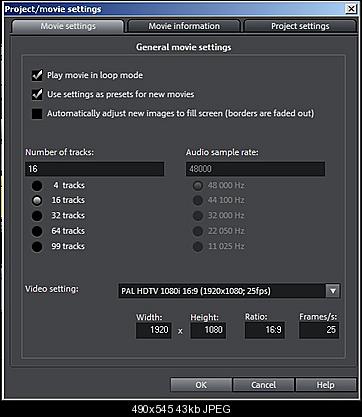

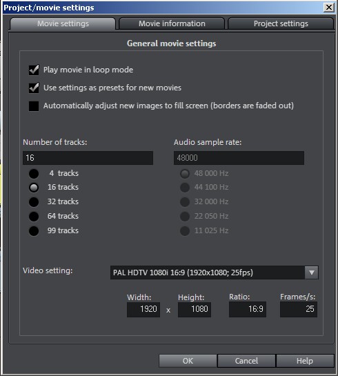

    My typical project settings:
    It should be pretty easy to do a custom in MEP as well - at least then you can customize it exactly how you want;

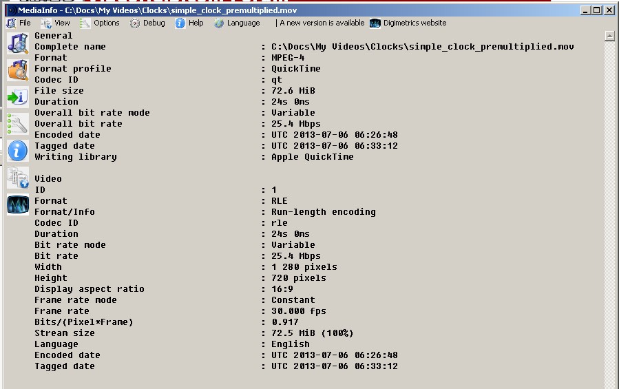

    but I guess the problem is you can't export it with embedded alpha channel to use in other projects.

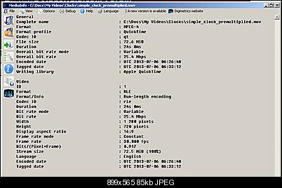

    Unfortunately that's the case. Was that one you sent me made with 'embedded alpha channel'. If so, is there anything here in MediaInfo's report that tells me that?

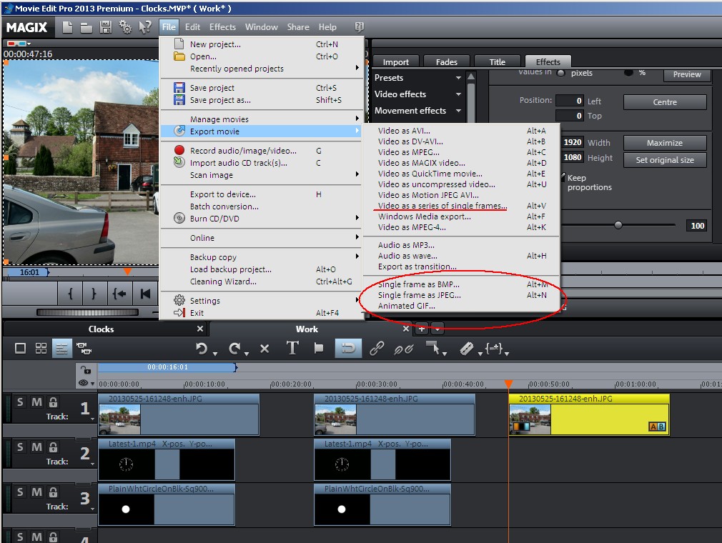

    If your program can export PNG with alpha, you can export an image sequence instead
    That looks like a No too.
    Yes it was. In 99% of other video editors, you can just drop it on the time line. Mediainfo here doesn't tell you if there is an alpha channel . It's seems to be an incompatible format with MEP (which is weird , because this is one of the most commonly used formats for this purpose)

    Do you have a video sample where alpha channel works? or post a mediainfo report of it
    It's probably just a matter finding a proper format that MEP understands

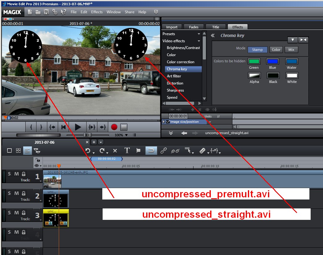

  11. Try this, pdr's clock converted to uncompressed ARGB AVI (in a ZIP file).
    Or this, pdr's clock converted to animated GIF with alpha channel (in a ZIP file).
  12. Try these tests too, RGBA, uncompressed AVI, one is premultipled alpha, one is straight alpha
    Just 2 frames to test if MEP "likes" it. (I inverted the colors - black clock face, white numbers/arrows)
    Some programs have alpha interpretation options, but I suspect MEP probably doesn't

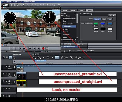

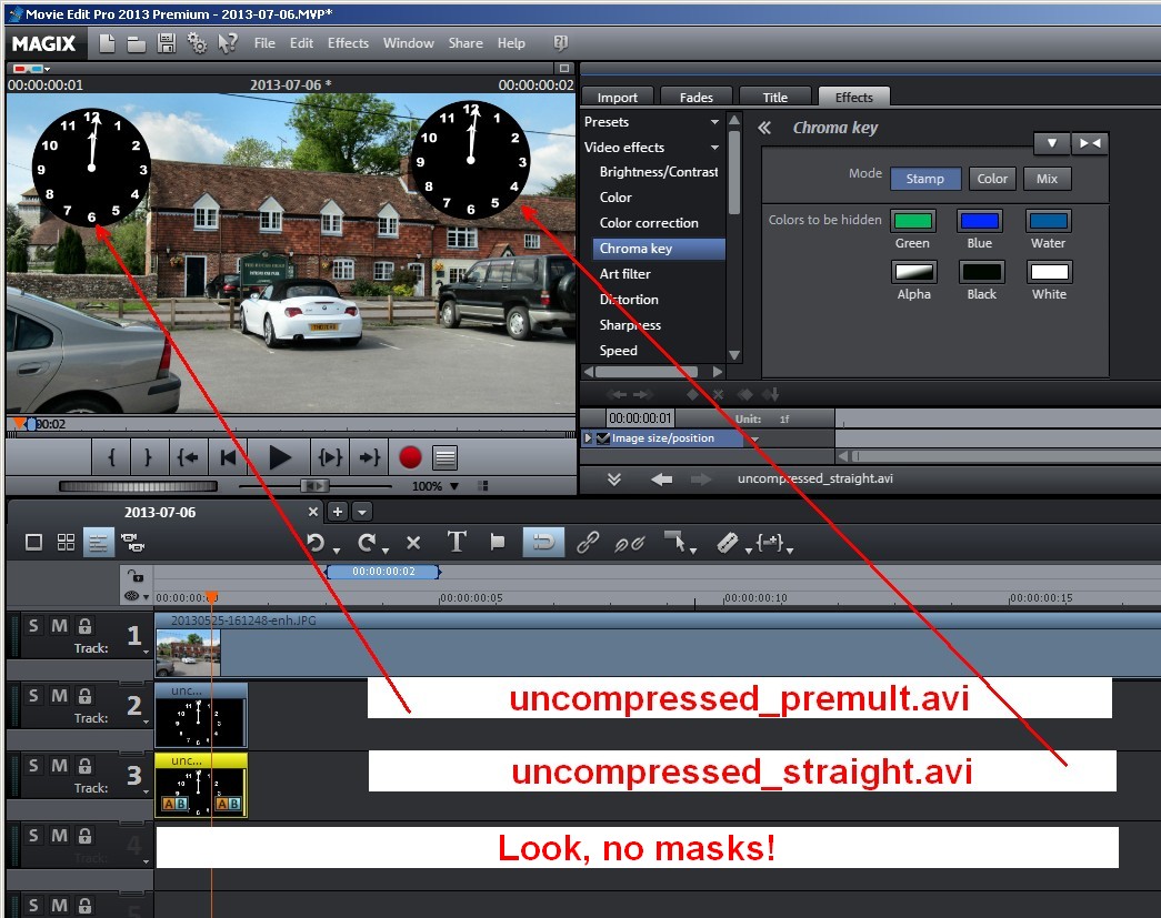

    I do now - the two you just sent me! They both seem to work fine, thanks. (But did you say they were negatives of the last one?)

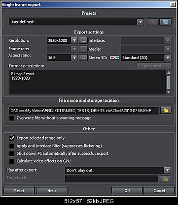

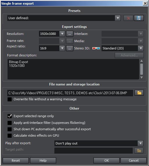

    BMP can have an alpha channel, see if there are options for that
    Don't think so.

    Well, if I'm still following correctly, both those formats you've most recently sent happily do cut the mustard, yes? If so, I'm looking forward to the full video. Preferably in black on white; now that I've seen it the black clock face while admirably readable does looks a bit grim, don't you think?
    Terry, East Grinstead, UK
    Don't think so.
    Look to see if there's a 24 bit vs 32 bit BMP option somewhere. The extra 8 bits is the alpha channel.

    The AVI is great - looks good and works directly with no mask. Huge size though at 2.5 GB!

    No - That was me guessing instructions on how to do a luma matte or mask in MEP - ie. if you wanted to key out the yellow clock without getting transparency in the numbers and arrows (since they were black)
    It's basically the same idea as what jagabo is showing in post #22, but with MEP
    https://forum.videohelp.com/threads/357196-How-to-add-transparency-to-a-video-clip?p=22...=1#post2252395
    [/quote]
    Understood.
    You just have to find a compatible format that MEP understands - so post the mediainfo report of one that works, and I can export it in that format , or someone can make a better, more customized fancy clock. I suspect uncompressed AVI will work
    Yes they seem to work ok on your screenshot . Was anything applied ? (any effects besides position and scaling) , or did you just drop it on the timeline ?
    That's odd, I thought the embedded images here were dynamic? I added 'Look, no masks!' in an edit immediately after posting #46.
