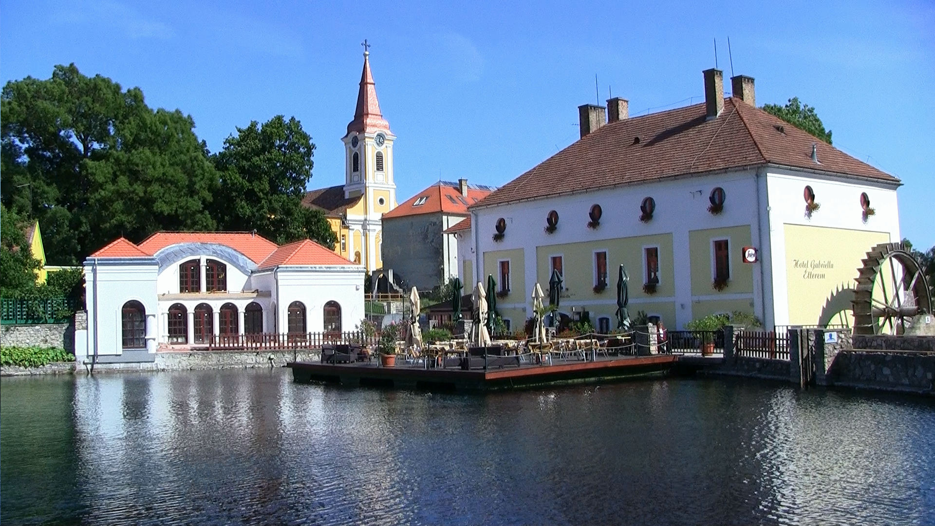

    The photos: (the first is a huffyuv , the second is an ffv1, the third is an utvideo bt.709)
    The Huffyuv and FFV1 looks similar/same. But the photo of UTI codecs' video looks different: Just look the colours of the roofs.

  5. flipping, between the screenshots iof ffv1 and huffyuv in my browser I can't see any color differences at all.
    Since I see no picture for ' Utvideo bt.709' I would guess that they use different color conversion methods bt.709 vs. bt.601 (edit: UT image is visible now)

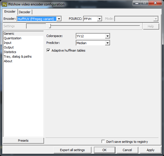

    Than try FFDSHOW encoder, and you can use it!

  22. What jagabo said above is important. When you look at a PNG screenshot it's RGB, not YV12. If the software you're using doesn't do the conversion properly it will look incorrect
    When done properly, all 3 should be the same . I've tested this before.
    It's possible Adobe be doing something wrong (the "handshake" between adobe to the encoder might be a problem) , or it's possible your screenshot software is wrong .
    If you want to find out what the problem is - upload a tiny clip of each 3 , ulh0, lags, ffv1 (only need 1 frame , really) we can check
  23. Originally Posted by Stears555 View Post
    Dou you think that UT video (ULH0) bt709 codec was better?
    Assuming your video was rec.709 (it wasn't flagged) the UT snapshot was closest to correct.
    By the way, even if a video has properly flagged the colorspace you can't assume software will handle it correctly. You should always verify the software is doing what it's supposed to do.
