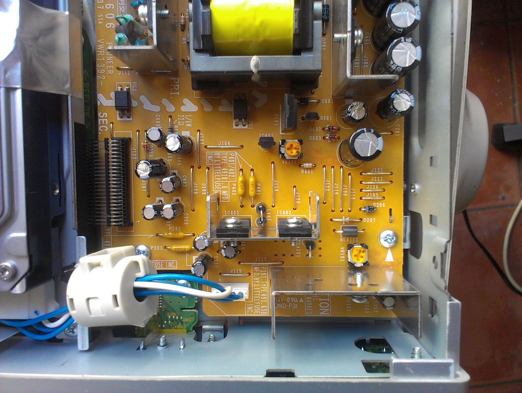

    Hi all,
    My Pioneer DVR-433H was recently used as a home for quite a large number of ANTS - needless to say there were eggs, or whatever those white little things were, all over the inside of the recorder.
    Now I managed to get them all out by taking the cover off and putting the machine in a bright sunlit area, but still had to persuade some to leave their new home with a paint brush.
    Problem is that now that the recorder is nice and clean and ANT-free, the DVD drive does not read any discs at all, I know that sound all too well from working with PC drives. Now I know there are adjustment parts that can be used to set the focus (that could have gone out when I cleaned it with the brush) and another adjustment (alignment is it?). But ok the DVD unit I also opened later to check if there were ants in there as well (and there was). Now I'm not sure where things went wrong, for instance 1. Maybe the ants left dirt on the Lens? 2. The adjust of VR101 & VR401 was disturbed by the cleaning?
    btw. the top of the lens is perfectly clean, but I do not know if there is another lens below the top one?
    I would like to see someones recorders position settings of the adjustment of VR101 & VR401.
    And secondly how to clean the lens properly.
    Thanks.

  8. The pots at VR101 and VR401 look OK to me, about the same as I've seen in the Pioneers I've serviced. It is extremely unlikely that you dislodged their setting by dusting them with a paintbrush: they hold their settings pretty firmly, and even the Pioneer 433/530 service manual does not recommend fiddling with them. If you did somehow manage to move them with the paintbrush, you probably wouldn't be able to reset them correctly by eye: Pioneer would need to do it for you at a service facility.
    When you say you cleaned out the burner, did you mean removed it entirely from the chassis (disconnected it) and opened its case? If so, that might be part of your problem. The 433 was one of the last "100% designed by Pioneer" models, and those don't like having their drives removed and reinstalled. Depending on the specific unit, some of them require use of a special service remote and service dvd to reinitialize the the drive(s) after removal/reinstallation. Usually one can tell from the front panel and/or what the onscreen display shows when you first power it on. If you are seeing anything but the usual time display, such as "E01" or "CPRM Err," the recorder wants the service tools to reinitialize the drive(s). If all displays are normal, your particular 433 doesn't need the service tool reset, but the ant residue probably gummed up the laser mechanism. Getting rid of the ant residue could be a daunting task if major disassembly of the drive is necessary.
    This recorder is eight years old now: as hech54 suggested, it has already lasted well beyond its expected lifespan (and the DVD drive could have coincidentally just failed from age). The most efficient course of action might be to replace the DVD drive entirely: you can do this following the instructions posted here. You'd need to find one of the generic Pioneer DVR-109 or DVR-A09 burners that were sold for PCs or Macs, and swap its controller board with the one in your original recorder. The controller board is rarely the cause of Pioneer burner problems: the laser or drive mechanism fails long before the board. By swapping the board into another, still-working burner, you trick the 433 into thinking it is the same burner it came with, while getting a nice clean replacement laser and mechanics. You need to swap the controller board because the one used in the generic Pioneer 109 burners made for PCs does not have the special proprietary connectors and firmware used by the 433.
    Before seeking a replacement burner, you should briefly remove the controller board from your "dead" 433 burner, and examine it carefully on both sides. It is possible such a severe ant infestation could have damaged some of the circuit traces or parts on the board. If you see any sign of deterioration or damage, it is likely the board is faulty and cannot be successfully recycled in a new burner. In that case, forget about repairing the 433 and consider buying a replacement recorder.

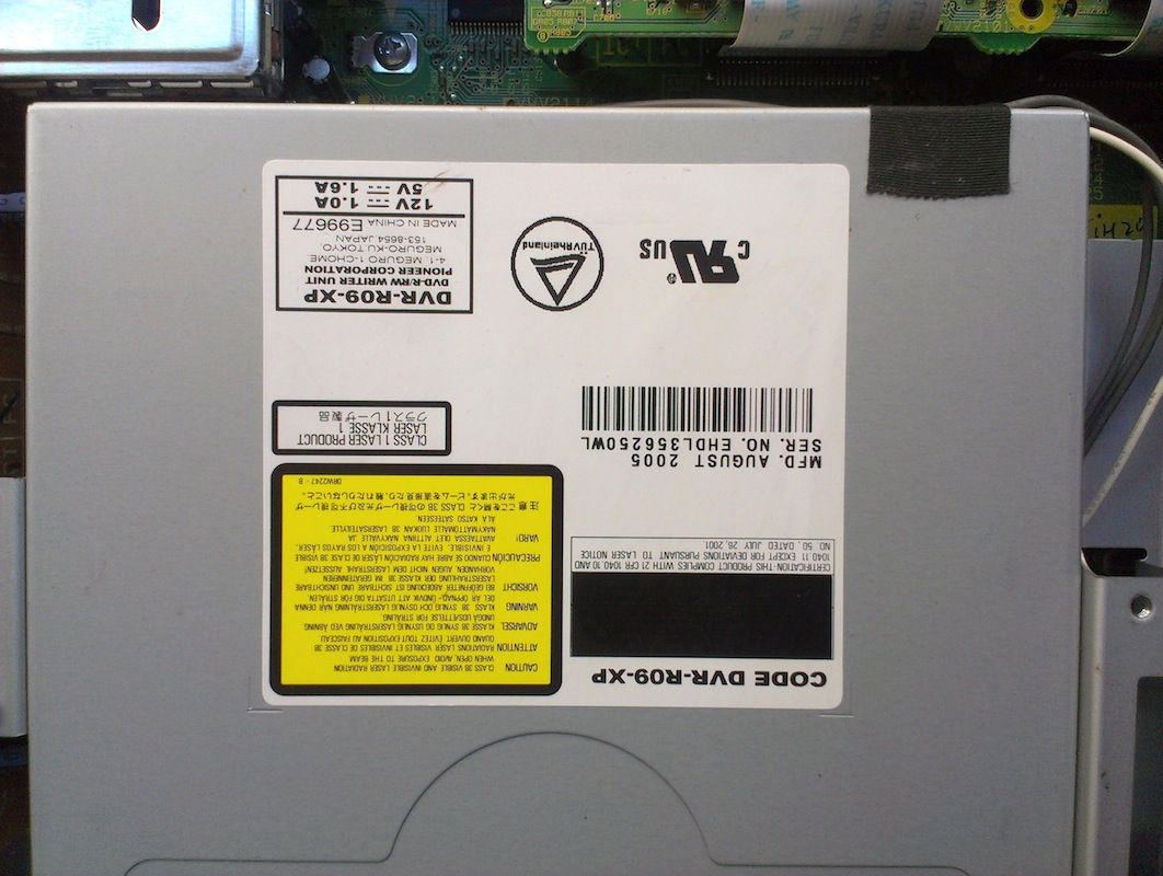

    Yes the laser is still lighting up, just tested it.This is what the unit looks like now.

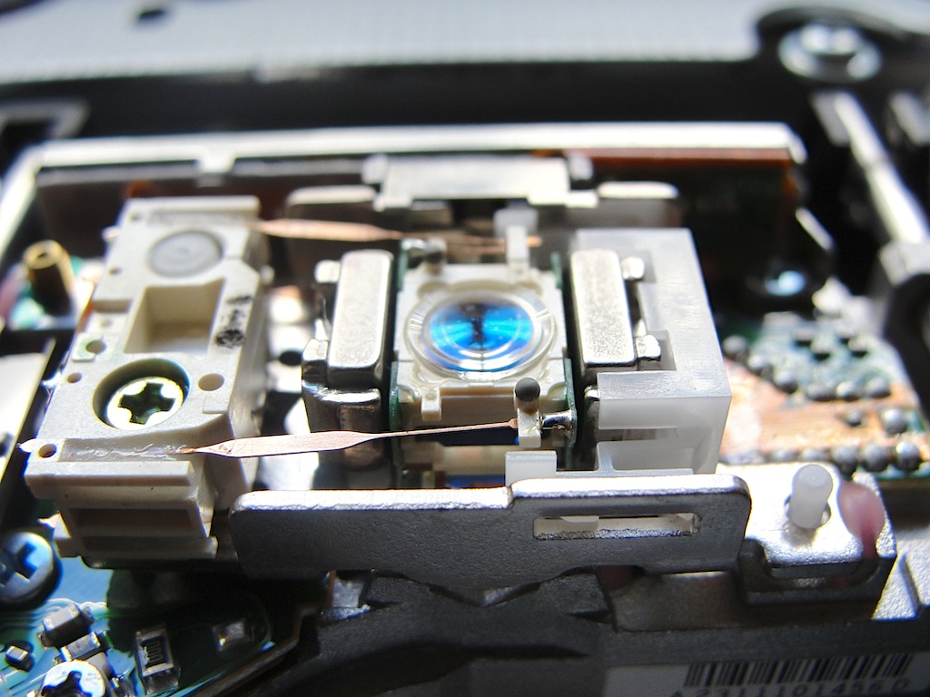

    Yes the bottom has two plates covering the lenses/mirrors; I went ahead and removed them and
    could see all of the lenses/mirrors I cleaned it as suggested, so it looks good there. (sorry, in this photo they were put on again)
    btw. I did not brush in here at all cause it was still clean enough - only a few ants got in when I ejected
    the tray before I opened the recorder shell - I just had to blow the out.

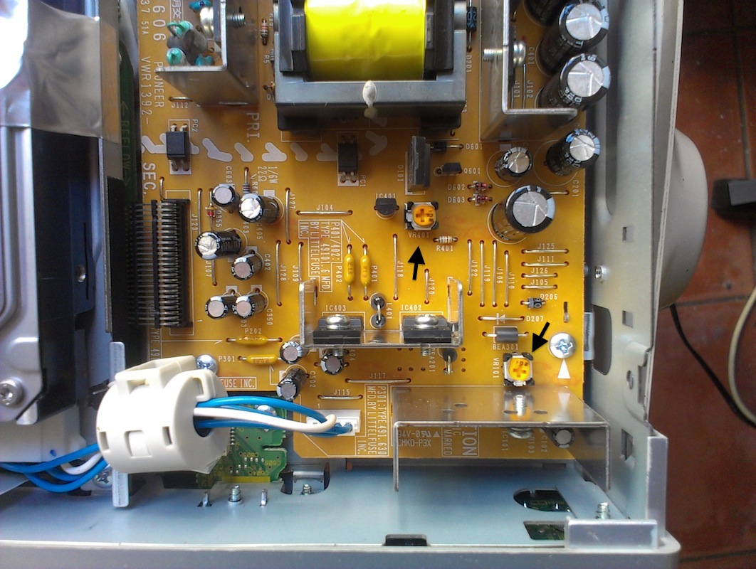

    What did got disturbed was the two orange pots?(don't know if that's what they are called) on the power supply board (in my picture)
    Do you know what they actually do? Cause I have to reset them to their original positions

    Ok thanks guys for all the info and help - thing is the rails are out, but the head is perfect (untouched), and VR101 & VR401 are out.
    I'm calling it quits since I only really wanted to use the unit as a player (CD/DVD) and not recording since I have a Pace PVR setup already. btw. This unit playes Audio CDs very, very well (do not know how they managed it) but sounded just freaking wonderful with my Marantz AV amp and Wharfedale Diamond 10s (better than the NAD 5000 player I had) - just a pity it's dead now. I hear the new Pioneers are not as good as these units were and Marantz players are too expensive really as an option. Someone know if any of the new Pioneers players that would sound as nice as this one did (normal size)?
    Thanks again.
