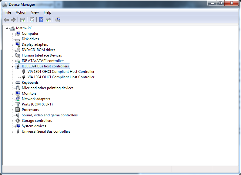

    However, I do have a digital camcorder, JVC GR-DVL9800, which can do passthrough, so I can connect the s-video to the camcorder, then hook up the firewire cable to the camcorder and pass it off to the pc. I also have several DV tapes that I'd like to capture off from the camcorder, but for some reason, no program is recognizing that I have a firewire card installed. Any help with that?
    Device manager correctly says that I have it installed:

    @Nightshiver More information might help someone figure out why Firewire isn't working for you. What is the make and model of the Firewire adapter that you installed, and what software fails to recognize that you have a camera connected to it?
  13. Look at the IC on the firewire card. If it's not TI (Texas Instruments) you may have have better luck with a TI based card.

    It's a rosewill. http://www.amazon.com/Rosewill-RC-504-FireWire-1394a-Ports/dp/B004F3DM6C/ref=sr_1_1?ie...ewill+firewire
    And now it works. Turned the computer off and looked for any sort of lose connections but couldn't find any. Turned computer on, went into device manager, uninstalled the drivers and then did a scan for new hardware. Dunno why it works now, but it does.

    I have found that sometimes re-seating a card or re-installing drivers does help.
    I'm glad it is working now. I have recommended that same product to a few people on account of the many good reviews it receives. TI chipsets have a better reputation, but Firewire cards with TI chipsets have become scarce and expensive, so its often either a case of take a card with a VIA chipset or do without Firewire.
