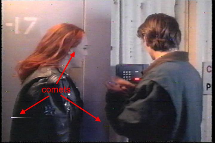

    What are comets? Are they like spots?
  6. Originally Posted by hizzy7 View Post
    Comets are short black or white horizontal lines.
    They appear in different places each time you play the tape. In second (or more) generation tapes they may be recorded on the tape and appear every time you play the tape.

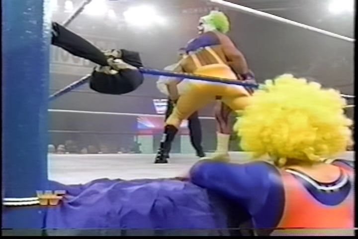

  14. Does anyone know why I'm seeing interlacing artifacts on my 720 x 470i video when using RemoveSpotsMC? I first encode to a lossless AVI in VirtualDub using this script:
    setmtmode(5,9)
    Mpeg2Source("E:\2 = New\\Dec 6 test.d2v", CPU=6)
    setmtmode(2)
    RemoveSpotsMC(last, 0)
    Then I encode the AVI to h264 with this script:
    setmtmode(5,9)
    AVISource("e:\2 = New\Dec 6 test just Daa3 scripts to lossless.avi")
    setmtmode(2)
    McTemporalDenoise(settings="medium", interlaced=true)
    AssumeTFF()
    QTGMC(Preset="Super Fast")
    Vinverse() AddGrainC(var=1.0,uvar=1.0)
    SeparateFields() SelectEvery(4,0,3) Weave()
  15. Originally Posted by VideoFanatic View Post
    Probably because that filter isn't interlace aware.
  16. Is there anything I can do to prevent artefacts? It seems to not handle camera flashes very well and the frame rate doesn't look as smooth as it originally did.
    I tried this but it doesn't prevent the problems:
    Separatefields() RemoveSpotsMC(last, 0) RemoveSpotsMC(last, 0) Weave()
  17. Yes, SeparateFields should work. Though, I'm not sure what will happen if a flash only lasts for one field -- it may remove the flash. And rather than calling RemoveSpotsMC multiple times try calling RemoveSpots multiple times within RemoveSpotsMC. For example, make your own variation of RemoveSpotsMC called RemoveSpotsMC2x that calls RemoveSpots twice.
  18. Could you post a script for that please as I don't know how to do that.

  21. Themaster could you help with this at all?
    Jagabo I tried your massive script. It reminded me that that script was the one I tried long ago which I couldn't get working. All I did was comment out the SpotRemover load plugin line and it worked.
    Upon viewing my OP video in AvsPmod it completely removed all comets with just one mentioning of RemoveSpotsMC(last, 0). However once I viewed a different video (mentioned below) on my TV I could see that it removes a lot of detail as well so I don't think it's a suitable script to use unless you know of a way to get it working?
    Examples:
    Different source video from my OP with more movement so you can see problems if there are any
    Massive RemoveSpots.avsi script (used RemoveSpotsMC(last, 0) in avs file)
    Small RemoveSpotsMC2x.avsi script (used RemoveSpotsMC2x(last, 0) Separatefields() RemoveSpotsMC2x(last, 0) Weave() and two mentionings of RemoveSpots() in avsi file.
    With either script I had to encode the RemoveSpotsMC(last, 0) script in VirtualDub to a lossless AVI as it wouldn't work in other encoders. Then I converted to h264.

  30. Before discussing that issue further, I have a bit of an emergency regarding the Comet Removal script on the whole file (720 x 480i). I'm getting interlacing artefacts when viewing a Bluray on my PS3. Yet when I view the same video on the PS3 Media server or a Media Player (not the Bluray just the TS file) I don't see interlacing artefacts. Here's a 7 sec clip of the original MPEG2.
    Below is the script to remove comets (I know this short clip doesn't have many but it's just an example so you can see what the script does to the video). I make an uncompressed AVI with this script. Then I convert to h264 and use McTemporalDenoise and QTGMC and I reinterlace after QTGMC.
    setmtmode(5,9)
    Mpeg2Source("E:\2 = New\7 secs.d2v", CPU=6)
    setmtmode(2)
    AssumeTFF() # Tried with and without this line but there was no difference
    Daa3()
    Overlay(last, last, y=-4, mode="chroma")
    Tweak(Hue=20, Sat=0.4, Bright=0, Cont=1.0,  Coring=False)
    Crop(16,0,-14,-18)
    AddBorders(16,10,14,8, $000000)
    Here's the RemoveSpots.avsi file.
    It's definately something in this script that's the problem because when I convert to AVI with no script at all then convert the AVI to H264 using the script below, I don't get interlacing artefacts.
    AssumeTFF() QTGMC(Preset="Super Fast")
    Crop(16,0,-14,-18)
