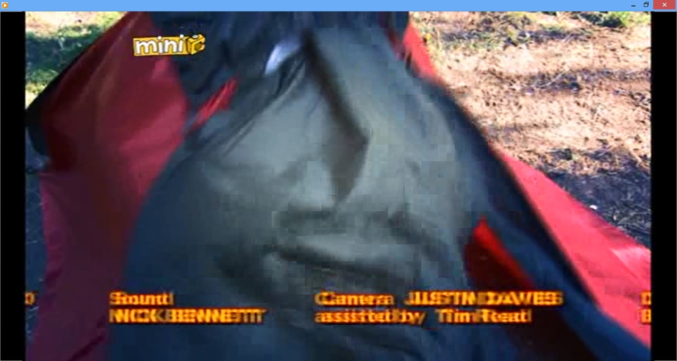

    However, I then tried doing it on another show (sooty if you must know ), which is not a cartoon, and at the end of the file, the credits scroll horizontally across the screen. Well, this came out really weird. Any example screenshot below:

    Now, I managed to create another script, which seems to have worked great, and resolved the weird credits, but it only gives an fps of 20, rather than 25. Here's a copy of that script:
    mpeg2source("D:\Converting\Demux\20120618 1037 - CITV - Sooty.d2v")
    TFM().TDecimate()
    LanczosResize(608,336)
    ConvertToYV12()
    Now, can anyone give me any pointers as to how to change the fps to keep it at 25? I tried using AssumeFPS(25, 1, true) command in the script, but this just seemed to make it look like they were on speed! lol...

  2. assuming you want 25fps since your source is PAL content:
    TFM().TDecimate() is ment to IVTC a telecined source.
    Telecide acts on telecined progressive source and attempts to recreate progressive frames.
    both are not ment for PAL content.
    -> assuming you do this since your source is interlaced, you might want to use a deinterlacer instead of methods which are ment for telecined NTSC content.

  4. try a simple
    bob() #this will double the frame rate and frame count
    instead of
    TFM().TDecimate()
    to first see this effect really way due to the IVTC
    If that helps you can switch to in example Yadif (http://avisynth.org.ru/yadif/yadif.html) or another deinterlacer (see: http://avisynth.org/mediawiki/External_filters#Deinterlacing). Most people will probably prefer QTGMC, but it's a lot harder to setup than yadif.

  5. Originally Posted by lovelldr View Post
    Don't follow TFM with TDecimate. Put another way, leave off TDecimate from the script as its use is almost always for NTSC IVTC decimation.
    But Selur is right - this material might not be meant for TFM or Telecide at all (both are field matchers), but a general deinterlacer (ones such as TDeint or Yadif). If you don't know how to tell, please post a ten second example from the source, one with steady movement.

  7. If the material is really interlaced (and not, for example, phase-shifted) and if it really needs a deinterlacer such as Yadif, then you don't want to add in a field-matcher such as Telecide afterwards as there are no fields to match. I don't know cartoons to be created interlaced. That's what these are, right? I suspect there's more here than meets the eye which is one reason a sample might be helpful.
    I guess you're using the ColorMatrix filter because your source is Hi-Def?
  8. I agree, either replace:
    yadif() Telecide(guide=2,post=0)
    with:
    yadif()
    or provide a sample which shows why you think it is needed.

  10. normal interlaced sd mpeg-2 -> no ColorMatrix or Telecide needed,..
    # loading non-standard filters
    LoadPlugin("C:\Program Files (x86)\AviSynth 2.5\plugins\DGDecode.dll")
    LoadCPlugin("C:\Program Files (x86)\AviSynth 2.5\pluginsyadif.dll")
    # loading source
    MPEG2Source("D:\Converting\Demux\20120618 1037 - CITV - Sooty.d2v")
    # deinterlacing; other Deinterlacers are possible, see: http://avisynth.org/mediawiki/External_plugins#Deinterlacing
    Yadif()
    # cropping, to remove the black border
    Crop(2,0,540,576)
    # scaling to end up with a 1:1 PAR, other Resizers are possible see: http://avisynth.org/mediawiki/Resize
    LanczosResize(704,400)
    return last
