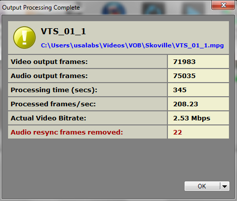

    These are the steps I took to 'rip' the video from the mini DVD leading to the screen shot of VideRedo's frame removal.
    1.....Using DVDDecrypter to create full DVD folders on HDD
    2.....Using VOB2MPG in IFO mode to create the mpg from the HDD VOB
    3.....Using VideRedo to 'Quick Fix' the mpg
    The result is this screenshot.
    Could the frame removal result in audio/video de-sync?

    Well I did not do step 3 but the report suggests that frames needed to be removed. What isnot clear from that is where the frames were removed. One frame every minute or so would not make any difference. 22 frames all at once would.

    Now a little more on those 22 frames. The muxing has sensed that video and audio is not synced so it appears to have added these. We know they are added when you come the new running time ie 40.1 to the old 39:59 (both numbers rounded up). But you need to play both to see which is better.

    As far as I'm concerned now,,, this thread is solved.
    ADDENDUM
    After posting this thread, I see can't even change the heading to show [SOLVED],,, oh well.
  30. Member DB83's Avatar
    Jul 2007
    Well it was said some time ago that the issue was the OS or rather your reluctance to accept that you really needed a second ie Non-OS accessed drive for editing etc.
    You cited the reason that you would invoke your guarantee by installing another drive. Methinks you have done that by installing an OS not provided with the system.
    But you did quote at least one software that did work for you or atleast it worked but not in the way you wanted. Does this linux based program really do all that you desire ?
