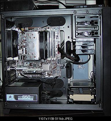

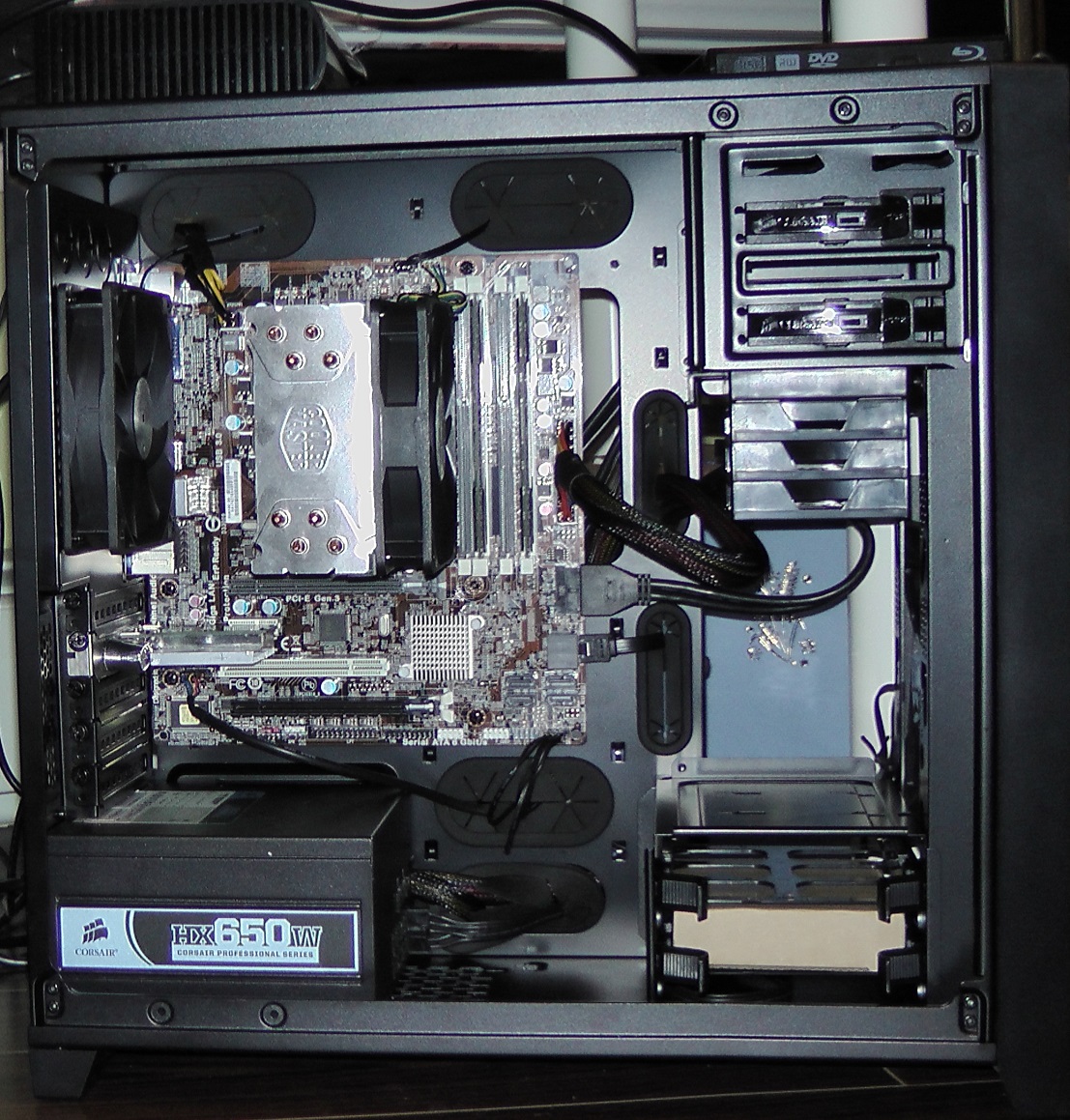

    I hesitate to follow up since I didn't end up going for the hardware you suggested (except CPU+mobo!) but I figured maybe an annoying conclusion is better than none. I grabbed a couple eBay deals for the SSD and RAM. If those two components die I don't really care (I don't typically keep valuable stuff on my Windows drive).
    No long capture card yet, but here's how it looks right now with both side panels off:
Name:	2013-09-07 PC build.JPG
    Intel Core i5-4670 Haswell 3.4GHz LGA 1150 84W Quad-Core CPU = $219.99
    ECS Elitegroup Micro ATX H87H3-M mobo = $79.00 (Amazon Marketplace)
    OCZ Agility 3 60GB SSD = $47.53
    Crucial Ballistix Sport VLP 8GB (2 X 4GB) DDR3 1600 = $49.99
    Corsair Obsidian 350D Micro ATX Case = $82.74 + $9.93 CAD (price-beat + tax) = ~$89.11 USD
    Corsair HX650W PSU = nil*
    Cooler Master Hyper 212 Plus heatsink/fan = $24.20 + $2.90 CAD (price-match + tax) = ~$26.06 USD
    US parcel receiving fees = 4 x $3.50
    Total = ~$525.68
    *I cheated: I already had a sealed Corsair HX650W PSU sitting on a shelf, so I didn't need to factor that in. (The PSU only cost me shipping; my 4.5 year old HX620W died last year and they honoured the warranty. Mind you, while waiting for the warranty process I bought myself an HX650W that is still in the other PC.)
    For the case, my other option was the Cooler Master N200 at half the price of Corsair's 350D. I was lured in by the two USB 3.0 ports at the top rather than the single one in the middle, but now I'm regretting letting that sway me since I'm looking at adding a cheap 5.25" fan controller and there are many that offer two USB 3.0 ports via the mobo header. Ah well; the other thing that I liked from reading about this case was the opportunity for cable management behind the motherboard, and I did enjoy doing everything up neatly!
    Somehow this thing is slightly larger along every dimension than the 5 y/o mid-tower that I have been using as a stopgap...

    I am envious. My planned system upgrade keeps getting pushed back.
    I really like that case. It is handsome, well-made, and roomy with great cable management features. The Cooler Master is nice too, but does not seem as well built. I hope the CPU and motherboard live up to their reviews. Good job!

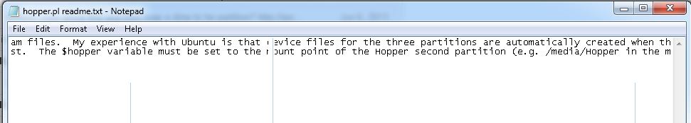

    Originally Posted by vaporeon800 View Post
    I just remembered some issues I've had with the integrated graphics:
    • Momentary random "corruption": for example, scrolling in a text document and portions of the screen fail to update such that some letter segments are from before the scroll. It doesn't fix itself; it stays garbled until I do something else to update the display (scroll more, minimize the window).
    • DXVA playback of H.264 files in MPC-HC almost always starts with a green screen, followed by a semi-garbled green display as it gradually morphs through motion compensation to start resembling an image and finally becomes the correct output once it hits the second keyframe in the file.
    • Using "Stretch to window" mode in the Capture module of VirtualDub, the overlay fails to keep up with the live input and drops batches of frames.
