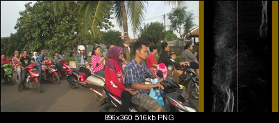

    Note - this 709/601 is not a big difference ( as the differences depicted in his "comparison".) Rec709 vs. 601 is just a slight shift
    original, RGB using 709, then resize
Name:	196 original,rgb709,resize.png
    original , RGB using 601, then resize
Name:	196 original,rgb601,resize.png

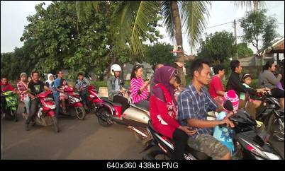

    Save these to your desktop & flip back & forth
    I believe his upper left screenshot in the bmp is correct - it shows VLC converting to RGB with 709 first (still 1280x720, RGB) , and then the resize. That's why the color borders will sharper, due to the chroma subsampling issue mentioned earlier (it has full 640x360 color, but a 640x360 4:2:0 conversion will only have 360x180 color information to begin with, no even taking into account compression issues down the line) . If VLC had resized then, converted to RGB with 709, the color borders would be slightly blurrier
    Original,resized , then conversion to RGB using 709
Name:	196 original,resize,rgb709.png
    Compare that last one with the other 709, and you will notice the thin edges around red lines is obscured. This is due to the loss in color resolution and subsampling . It's not a huge difference, but it's there

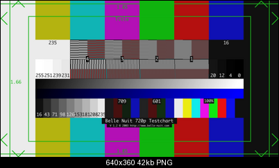

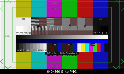

    Can you see the difference here? look at the text clarity e.g. the green word "title" .
ID:	18622Click image for larger version
    I took an 1280x720 RGB image, converted it to YV12 at 1280x720 to simulate the "original", then either 1) converted to RGB then resized it , or 2) resized it , then convert to RGB
    #1
    ImageSource("testchart720.tif")
    converttoyv12(matrix="rec709")
    converttorgb(matrix="rec709")
    bicubicresize(640,360)
    #2

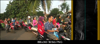

    These 3 are all from _Al_'s last video , the only difference between 1&2 is the renderer (it's the exact same video, played in the same player)
    1) original, how it looks normally played

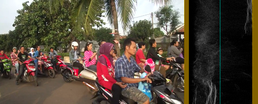

    2) changed renderer to vrm9 (renderless) - notice the waveform, how the black and white point are adjusted - this looks similar to your Top Right comparison (I would guess maybe vrm9 or vrm7 were used in that one)
    3) same as #2, but used a levels filter to try match back to the original
