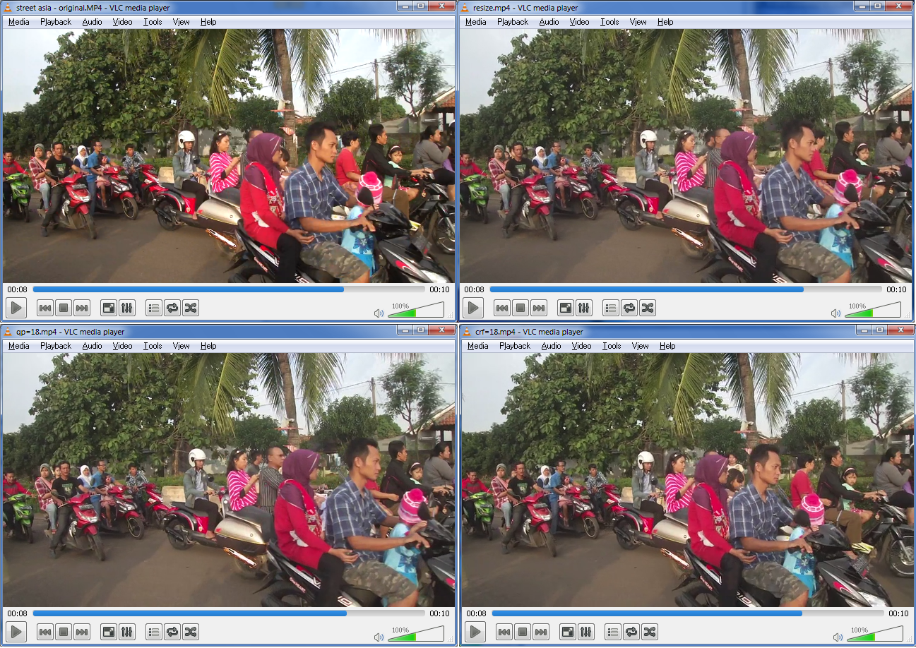

    thanks for your samples. I attach a picture for the comparision of them all. The first pic is the original resized in the player. The colors are better than the other samples. So does it now mean it is not possible to achieve the same thing for converted videos?
    I simply want to preserve also the colors. You see the dilemma? if those pixels remain in good quality when resizing the player, does it now mean we can not convert it like that at all?
    Your conversions dont differ with the ones I did, it got a bit sharper but still the color quality is lost. So, this is really normal? We cannot preserve the colors?

  30. There is no difference in color or levels with DB83's example (I didn't look at _Al_'s , but it's probably OK too in terms of color or levels)
    You have a screenshot taking problem , or playback problem
    You probably have more than 1 player application open at one time (only one can use the graphics overlay, so the other instances will use another renderer , and look different)
