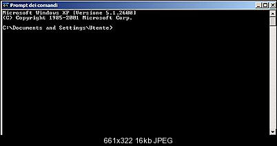

    This is the command prompt.
    I have the mjpeg tools on C:
    m2v and mpa files in the other hard disk
    So now what command I must write?
    Please help, no tutorials I found on the internet
  9. For command line, use quotation marks with the directory path eg. "C:\directory\folder\..."
    e.g.
    "C:\mplex" -f 8 -o "PATH\output.mpg" "PATH\video.m2v" "PATH\audio.m2a"
    Replace "PATH" with the real directory path
    Note there are easier multiplexing tools to use with GUI's like ImagoMPEG-Muxer , or muxman
