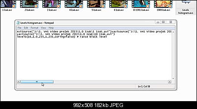

    (The whole script does not appear)
    If I use this script, the files combine as one file, but I want them as separate files, as they are all mixed now.
    Is there a way in which I can "edit" the files, but they still remain separate files and are not combined?
    Albie
  7. Banned
    New York, US
    Note: You do not have to make an image of a page in Notepad. You can copy the text and paste it into your post.
    The first line in your example script uses "+" to join clips together as one video.
    The "Levels" line darkens all the darks in your video, lowering them fom RGB 16 to RGB 1. Instead of
    Levels(16,1.0,235,1,235, coring = false)

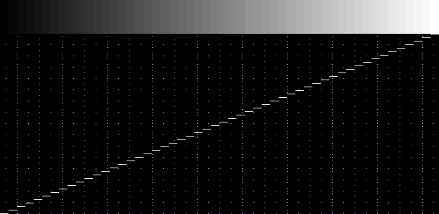

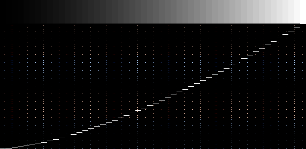

    The second argument is the gamma (1.0 is neutral, linear). It's used to bring out details in the shadows or brights without crushing brights or darks. Ie, it's a non-linear control. Play with VirtualDub's Levels filter and you'll understand it. Whether you want to use gamma or pull down the black depends on the black level of the source.

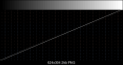

    Equally spaced grey bars video and waveform monitor (Histogram in AviSynth)
    gamma 1.0:

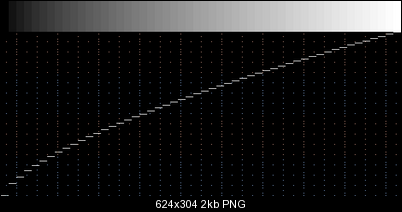

    gamma 1.5 (enhance shadow detail):

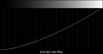

    gamma 0.66 (enhance bright detail):
