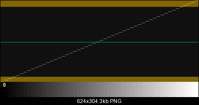

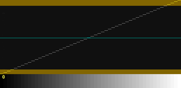

  5. If you're having problems understanding how ColorYUV() works you can use the attached animated script. Open the script in VirtualDub and you'll see the effect ColorYUV() has on the picture.
    At the bottom is the image being processed -- a series of vertical bars of different intensity, dark to bright. At the top is the luma graph created by Historgam(). As you scrub around in VirtualDub you'll see the shape of the graph and the brightness of the bars change. Modify the script to change off_y or gamma_y instead of cont_y.

  8. That script makes no sense. You should have run it exactly as it was. Just to see the effect of changing off_y, gain_y, and gamma_y with ColorYUV(). Make sure that bars.png is in the same folder as the script.
    If you want to see the effect it has on your video just replace the ImageSource() line of the original with AviSource("E:\Videos\1 Projek\4.avi").
