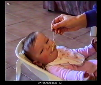

    I cut a few clips on VD last night, but forgot to compress it. These are the ones that I attach:
    General
    Complete name                            : C:\Users\ALBIE\Documents\Desktop\New folder\3 (1).avi
    Format                                   : AVI
    Format/Info                              : Audio Video Interleave
    File size                                : 35.8 MiB
    Duration                                 : 1s 200ms
    Overall bit rate                         : 250 Mbps
    Writing library                          : VirtualDub build 32842/release
    Video
    Format                                   : RGB
    Codec ID                                 : 0x00000000
    Codec ID/Info                            : Basic Windows bitmap format. 1, 4 and 8 bpp versions are palettised. 16, 24 and 32bpp contain raw RGB samples
    Duration                                 : 1s 200ms
    Bit rate                                 : 249 Mbps
    Width                                    : 720 pixels
    Height                                   : 576 pixels
    Display aspect ratio                     : 5:4 (see the difference again)
    Frame rate                               : 25.000 fps
    Standard                                 : PAL
    Bits/(Pixel*Frame)                       : 24.000 (see the difference again)
    Stream size                              : 35.6 MiB (99%)
    Audio
    Format                                   : PCM
    Format settings, Endianness              : Little
    Format settings, Sign                    : Signed
    Codec ID                                 : 1
    Duration                                 : 1s 200ms
    Bit rate mode                            : Constant
    Bit rate                                 : 1 536 Kbps
    Sampling rate                            : 48.0 KHz
    Bit depth                                : 16 bits
    Stream size                              : 225 KiB (1%)
    Alignment                                : Aligned on interleaves
    Interleave, duration                     : 63 ms (1.58 video frames)
    Interleave, preload duration             : 500 ms
    Unfortunately, due to space constraints, after editing, I deleted the original files that were captured in Virtualdub.
    1. As the quality varies so much, I realize that I cannot use a lot of AviSynth or VD plugins, but would appreciate a comment on one or 2 filters that might just be helpful. I suppose these will probably have to do with VHS artifacts, sharpness, noise and color.
    2. Before I save these files as my final AVI's and before encoding them to mpeg2, should I run them through Virtualdub with specific settings?
    3. It is difficult to see if there is some distortion in the frames: 4:3 in stead of 5:4
    Apologies for the long post

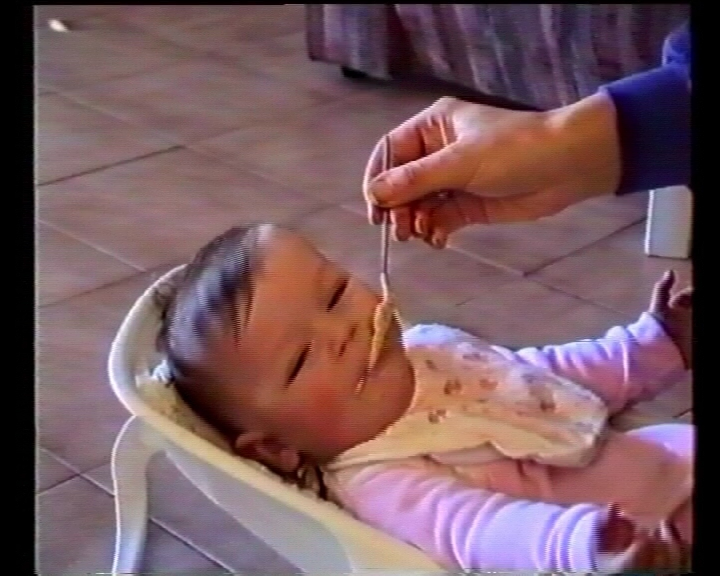

    1.1.avi: oversturated and elevated red. Can be fixed with ColorMill. The "rip" (thin gray horizontal streak) extends over too many frames to be fixed in VirtualDub, but the built-in temporal smoother set to about 4 or 5 cleans some of it. IF the "comb" effect bothers you, view the video in a media player than deinterlaces during play. If you want PAL DVD as a final product, PAL DVD is usually interlaced for smoother motion on TV. Players and TV will deinterlace while they play. Otherwise, the interlace comb effect can be fixed in Avisynth. You can deinterlace with VirtualDub's yadif deinterlace, but its quality will be inferior to the way Avisynth plugins could handle it.
    3(1).avi: The streaks can't be repaired in VirtualDub. They might be partially fixed in Avisynth. The green flutter across the top border can't be fixed in VirtualDub.
    3.avi: The streak can't be repaired. The frame with the blue/green flash can't be repaired with VirtualDub. Gamma is slightly too high and the middle tones need more red (can be fixed with ColorMill).
    5(1).avi: the streaks can't be repaired in VirtualDub, but might be partially fixed in AVisynth. The magenta discoloration (rainbows) in the blue shirt can be partially repaired with Camcorder Color Denoise, but can be almost completely eliminated in Avisynth. Yellow stain along the bottom can be masked with VirtualDub's "Border Control" plugin, but could be cleaned less destructively in Avisynth.

    I did some cleanup on the 4 AVI samples. They have field order and interlace problems. I never did figure out what the field order should be on a couple of these, but pricessing was done as TFF; they are encoded as BFF. I undewrstand European VHS-C to be BFF, but the tape playeys plays them as TFF and (I think) PowerDirector made them BFF, and fouled up interlacing. Something in your processing chain is generating a 16x16-pixel noise pattern. There is also dot crawl and sawtooth edges (aliasing from improper interlace, and by re-encoding ???). I'm not sure whether these were once DV, or how you processed the originals. The problems are obvious in the 2X blowup image below:
    [Attachment 18655 - Click to enlarge]
    Attached is a .zip of 4 text files explaining the plugins used. Most of the work was trying to eliminate streaks, including the green top-border noise in AVI 3-1. The green can't be fixed because this video has already gone through 2 stages of RGB. The 16x16 grid noise shows as faint horizontal lines. Encoding these to PAL MPEG will often result in blocky grain. Not all streaks could be fixed. This is frame-by-frame work. It would take forever.
    You should find a tape player with better tracking that won't inflict further damage. Try to keep field priority consistent. Now that ytour original captures are gone, fixing the remainders would be very difficult.
    Last edited by sanlyn; 19th Mar 2014 at 12:07. Reason: post new Scripts_all.zip with corrected typos

    Understood. I'm trying to say that something is amiss with the O.P.'s capture setup or capture gear/software, as regards both the field order (which seemed to change and then re-set for several frames in one of the short samples, 1-1.avi), interlace artifacts, and the 16x16-pixel noise pattern. I don't have an answer for the O.P. concerning those problems, I just reported that I saw them. Unfortunately the original captures are gone, so we have nothing to compare. Nor do I fully understand why 3 of the samples encoded correctly as BFF (while TFF was required during filtering), but a fourth would only encoded properly as TFF. So some sort of field out-of-sync condition exists, but I don't know what intermediate processing those AVI's went through.
    MediaInfo reports BFF in an early post here. Yet viewing them as BFF separated fields or deinterlaced frames in ViurtualDub gives back-and-forth motion.

    The 1-1.AVi of the infant is obviously too red and contrasty, with mixed lighting sources. If you filter to correct it, the same settings won't work with the 5-1.AVI of the elderly kinsman; that scene has a different problem -- it's too blue. The girls jumping up and down had oversaturated bright red that appears to "glow". If you correct that with one set of color filters, the infant child in the other scene will look green.
    I assume you're not using histograms or pixel samplers. Professionals pay high prices for programs having those tools, but VDub's versions are free. They aren't difficult to learn. Free tutorials on Photoshop sites have good, clear, brief examples of how color histograms are used to analyze and correct color and contrast. The VDub ColorTools histogram is similar to those in high-end programs. Camcorder Color Denoise and VDub's built-in temporal smoother should be mainstay denoisers. 2D Cleaner and MSU's filters are too problematic, and they don't address the kind of noise in your samples. If you could get accustomed to using NeatVideo properly and moderately, you'll have several denoisers in one. Chroma cleaners (for color blotches, stains, and rainbows) won't be effective; those glitches should have been fixed in the original YUV captures.
    I realize that it's too late to remedy problems caused by copying tape to tape. Your JVC is a worthy VCR, and you definitely need its tbc. For future reference, I understand that there are adapters made for playing VHS-C tapes in VHS players. I don't know about their availability, or whether your JVC would like it.
    Other than the tech problems mentioned, your samples looked otherwise rather nice -- well, OK, the girls jumping up and down are a problem(!).
    I don't know why anyone would recommend PowerDirector. You could be working in lossless AVI with something like budget versions of Vegas (Movie Studio Platinum) or, probably better, Premiere Elements. I admit that Cyberlink and Pinnacle are easy to use, but I wouldn't recommend them. I have opened huffyuv and Lagarith videos in many editors, without problems -- but not in PowerDirector.

    I suspect that many DV captures might have been decompressed to RGB AVI's, taking up more storage space.
    Viewing the dot dot pattern in VDub with yadif turned on, the older man (5-1.avi) has dots on Odd fields -- but Even fields are too blurry to make the pattern noticeable. On 3-1.avi (boy on stairs), dots are in both fields. I don't see it in the other two sources.

  19. Originally Posted by sanlyn View Post
    I agree. I've only seen 1.1.avi so far but...
    1) The caps are RGB. No capture device captures as RBG. Any that deliver RGB do so by converting the captured YUV to RGB. That's a waste of time and degrades quality. Capture as YUY2 or other YUV 4:2:2 chroma subsample format. PAL DV's 4:2:0 chroma subsampling is fine for PAL sources.
    2) There are macroblocks in moving parts of the video. This indicates these are not direct analog video captures but they have been through some kind of digital compression before these uncompressed RGB AVI files were uploaded. Maybe MJPEG or MPEG 2.
    3) The 8x8 dark pixel grid also indicate this was badly converted from some DCT compressed format. One field has dark dots, the other has corresponding light dots (though not as bad).
    4) The chroma channels of the video were mishandled. At some point interlaced chroma was treated as progressive chroma. This has caused the colors of the two fields to blend together.
    5) There are oversharpening halos from a horizontal sharpening filter, probably in the VHS deck.
    The OP needs to go back to square one and recapture those videos.
  20. By the way, if recapturing isn't feasible you can "fix" the 8x8 dot grid without damaging the picture too badly with a sequence like:
    SeparateFields()
    Undot()

    before:
    after:
