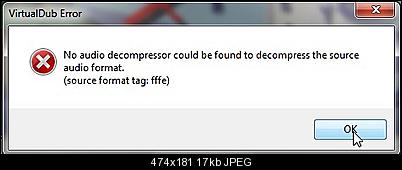

    Be aware that there are different versions of the FFDshow plugin and they all do NOT work with various problems in each. Some do not even show the file information when you click that choice. Below is the ones I keep in my plugins32 folder and the one shown being used fails on some AAC audio exactly as you mention. The one that says NEW works with the AAC when it fails on the other. I just change the extension and swap them out. The one that says fails does just that, fails in a LOT of areas.
Name:	ScreenHunter_11 Jun. 25 22.41.jpg

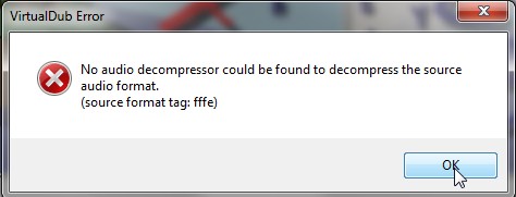

    And yes you will get this error also using the wrong one:
Name:	ScreenHunter_11 Jun. 25 22.48.jpg
    A work around that sometimes works with the correct FFdshow that still gives errors is to select Audio-> audio from other file and then just select the original video. This works most times if you do not care if you get the original codec for audio.

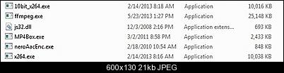

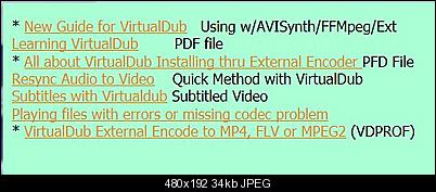

    Just an added note if you are looking to use VirtualDub to directly create an MP4... I have a vdprof set up for import that allows the 1.10.3 version to use as an external encoder in AVC/AAC format. You just need to place the NeroAAC and FFmpeg in the "C:\Standalone\VirtualDub1103\Tools\" directory or edit the path in the encoders.
    If anyone is interested I can send the links:
Name:	ScreenHunter_11 Jun. 25 23.19.jpg
    OOOps... Actually you need these External encoders, MP4box, NeroAAC, FFmpeg and x264. The others below come with these 4.
Name:	ScreenHunter_11 Jun. 25 23.41.jpg
