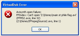

    Attempting to open in Virtualdub with the above version of ffmpegsource with ffmsindex.exe, ffms2.dll and FFMS2.avsi from the above installed in the avisynth plugins folder with this script
    FFMpegSource2("sourcefile.avi" , atrack=-1)
    I get this error:
    Name:  FF error msg.jpg
  4. delete the old index created the 1st time (in the z:\Disney folder, there will be a .ffindex file), remove ffmsindex.exe from the plugins folder
  5. Member brassplyer's Avatar
    Apr 2008
    Well, it helps if one actually spells the name of the source file correctly. I typed it in with a superfluous "e". After application of whiteout it now loads.
    *bang head on desk*
