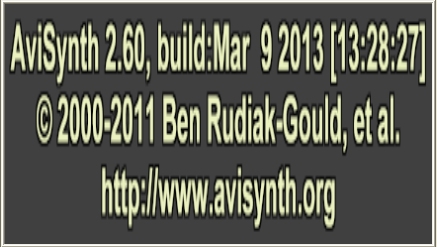

    Tried this with various setting, makes an even bigger mess. Now the resulting video is choppy and glitchy.
    http://forum.doom9.org/showthread.php?t=156028
    You might try some of the other suggestions too. For example, are you using a SEt MT version?
    Yes, using an SEtMT version.
