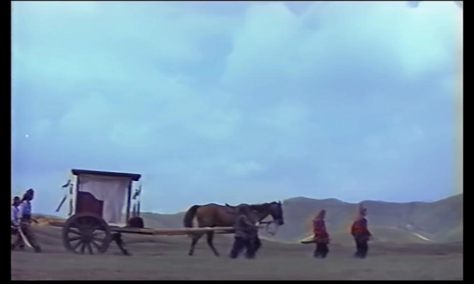

    From he big m2v posted in #54 several hours ago: three images from the same frame. All are sized to 480 vertical dimension, but different widths to attain different aspect ratios.
    A wagon wheel from the PAL m2v, as would be displayed at 4:3. Obviously not a round wheel. Rather a bumpy ride, even for those days (and you thought Toyota had problems!). A 4:3 frame from the original source would look just as egg-like. I think this demonstrates that the movie could not have been shot as 1.33333:1.
    [Attachment 18578 - Click to enlarge]
    Wheel at 1.37:1 aspect ratio. Okay, my guess was a bit off; this wheel is more round -- but no cigar. Looks as if it requires just a more outward stretch.
    [Attachment 18579 - Click to enlarge]
    Wheel at jagabo's suggested 1.66 image aspect ratio. Even closer to round, if a tad wide. The verticals spokes are a bit shorter than the horizontal. But it's a step closer. Of course there was earlier cropping and some original pixels are missing. So a correct image size for this flick is somewhere between 1.37:1 and 1.66:1 (recall that 1.5 was also being used in Japan back then).
    [Attachment 18580 - Click to enlarge]
    In any case, there's no way a 4:3 image accurately represents the original.

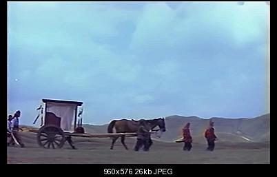

  26. Originally Posted by hizzy7 View Post
    Is it wrong to make it BilinearResize(656,480,18,2,-18,-8)?
    No. It's just a tiny bit wider. By the way, the script I gave was for the 720x576 PAL video in post #54, not the video in post #1.
    But sanlyn could be right -- maybe 960x576 is a little too wide. Also, the wheel is very close to the corner of the frame. Lenses often distort the image near the corners. And the bottom portion of the wheel is obscured by the grass. I'd rather find something of known aspect ratio, bigger, and near the center of the frame to get a more accurate estimate of the true AR.
    I was using this frame (1103 by DgIndex) because the side of the wheel is perpendicular to the axis of the camera (full frame enlarged to 960x576):
    In the frame sanlyn used the wheel is pointed slightly to the side.
