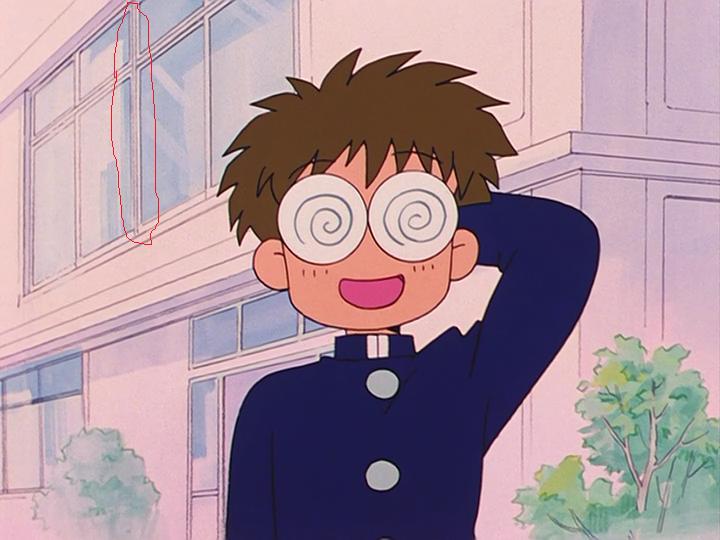

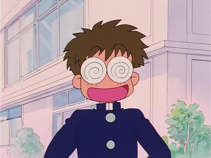

  10. In the first screenshot you can see that the lines look fine where the circled area is, but in the second screenshot where the circled area is there is a weird line kind of grain. Might be aliasing or dot crawl. I can't seem to remove it with antia-aliasing filters.

  11. You should post non-resized PNG files to show such fine detail. Resizing and JPG compression both produce artifacts so it's hard to tell what's in the source and what was caused by the processing.
    But looking at the MVK file: What you're seeing is a mix of noise, oversharpening halos, and DCT ringing artifacts, all exacerbated by over compression. Don't sharpen as much, use better noise reduction, and higher quality encoding.
    Higher quality encoding may not be necessary if you get enough noise reduction. If you don't want noise reduction (ie, you want to retain the grain noise) then you must use much higher bitrates and a higher aq-strength value in x264.
