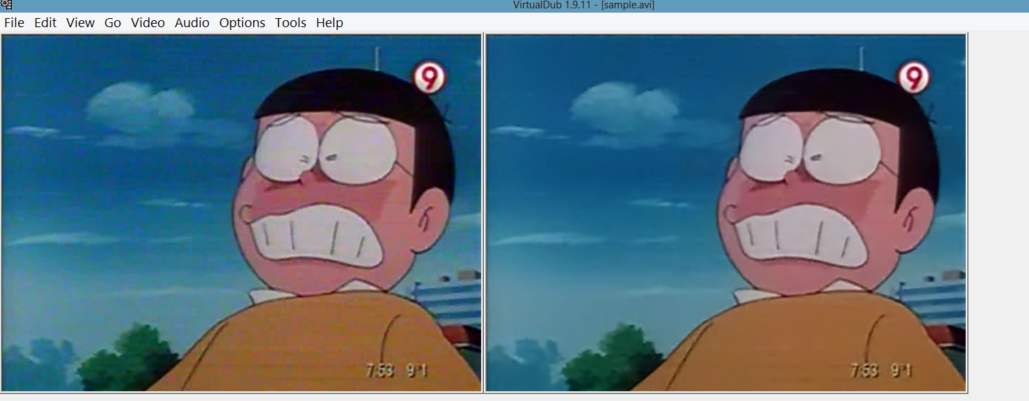

    Is it possible to stream live picture from the camera mode (not player mode) of an mini dv camera Panasonic nv ds60 I read somewhere that some models can do it. What i wanna do is basically capture what my camera is seeing trough firewire in digital format and recording it with windv (without recording it on the dv tape my tape system is broken). I don't have firewire cable now. The camera has analog video input and you can use it as analog digital passtrough ( as some here do). But can you record what camera lens see it trough firewire. I tried it with Svhs cable in to analog tv card and it works but can you use firewire so you get digital dv file.
    I am asking this because the camera says it can record ( probably on the dv tape I guess ) in progressive 24p mode and I plan to use it as real time 8mm film transfer.

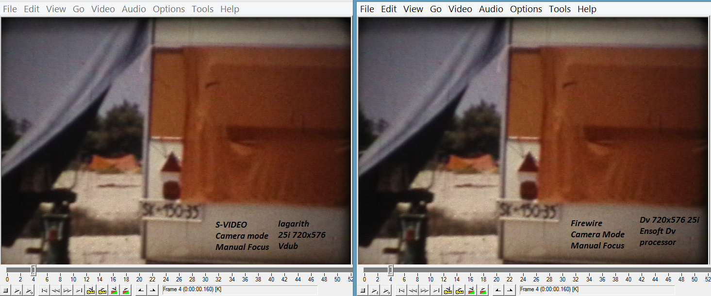

    Yes I know David but there is some workaround that with Videofred try http://forum.doom9.org/showthread.php?t=144271 but i used http://forum.doom9.org/showthread.php?t=161493 and it is very good it finds duplicates it restores the 18-25 fps from the 8mm film and after that you encode in fake 25 fps and use dgpulldown to make it more natural.
    The result is very very good ( for real time transfer ). I also use some neat video and camcorder color denoise in vdub ( which makes miricles on this setup).
    One think that i noticed ( i never used dv camera before ) that the picture looks like it is compressed ( i know that dv is compressed but it looks more compressed like Mpeg2 stream. When I used the camera with Svideo and into VDub capturing with lagarith the picture is more "flat" or "uncompressed".
    So one more question is the digitizing process ( when using camera mode) in mindv camera better then the old route I used digitizing trough PC TV card.
    I expected that connecting it trough firewire i will have less noise but it seems that the noise is coming from the camera sensor instead of the connection used
    What do you guys think?

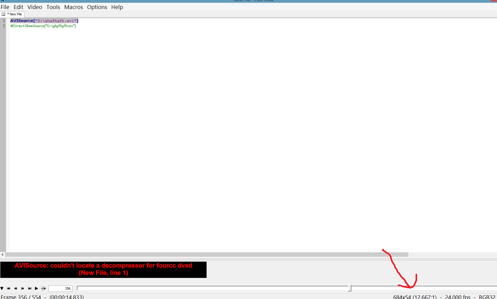

  9. Avysinth reports error if i try to open DV file ( type 1 and type 2 ) recorded ether trough Ensoft Dv proc ether with win dv if I choose direct copy in vdub will preserve dv?
    You don't say what your Avisynth error is, but you should be able to open your dv files in virtualdub without it (and without incurring the RGB color conversion it entails.)
    VirtualDub can do a directstream copy of DV with absolutely no loss of quality --if no effects are added. Cuts are fine.
  11. You don't say what your Avisynth error is, but you should be able to open your dv files in virtualdub without it (and without incurring the RGB color conversion it entails.)
    Will dv bff - lagarith YV12 ( fast re compress ) bff make seance i will filter the clip allot
    The error couldn't locate decompressor for fourcc dvsd as on the picture notice that avysinth is wrongly reporting the frame size

  12. Hmm, I have no clue why avisynth is acting that way. The windv mediainfo appears to be an absolutely normal PAL DV. (16 bit 48Khz sound is more usual, but this is fine.) The speed of the recompression to Lagarith will depend on your CPU.
  13. Member vhelp's Avatar
    Mar 2001
    New York
    dvsd is the fourcc for a dv codec.
    although (in your case) i find it hard to believe, but it sounds like you don't have a DV codec installed.
    to resolve, just download and install cedocida.

    Thanks I installed it and it works now. I have windows 8 64 by the way.

    As my initial toughs about the impact of different connections on same recording on the camera and on the 8mm projector interesting thing is that I didn't notice any difference.
    Take a look of the pictures side by side on the same frame ( looks like both pictures are in sync I wonder if we can use median 3-9 technic here and get god results because i think that noise ( scratches and spots are on the different places on different recordings).
