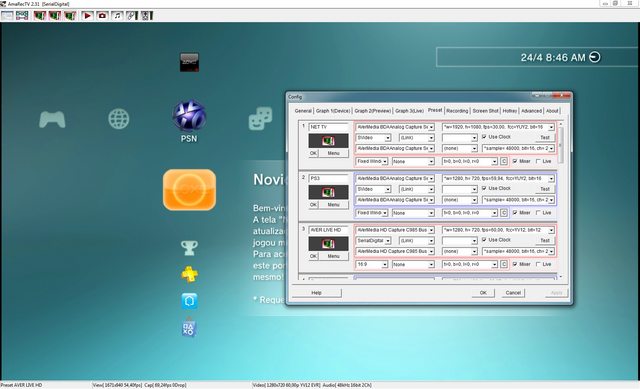

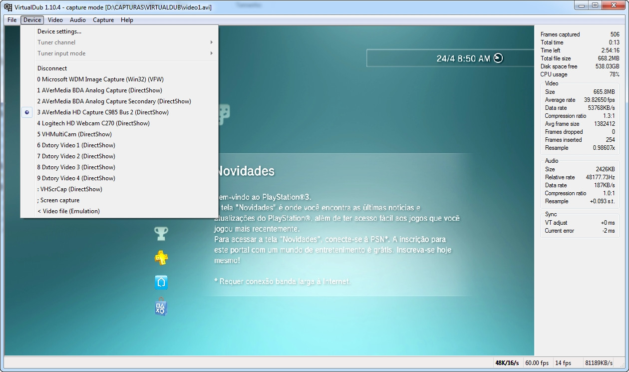

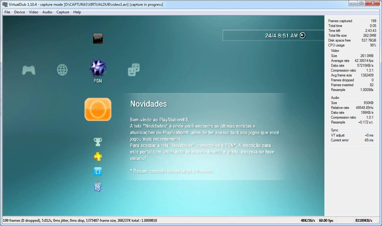

    That not the Avermedia Live Gamer HD C985
    Just adding: In latest driver version, my Aver C985 have DS support for Virtualdub and AmarecTV. Its a good replace for my Aver C027, but no have analog inputs.

    I have 4 PCI-e cards: 2 Aver C027, 1 Aver C985 and 1 Aver M799. Never trouble or issue in 4 years.
    My old C2D E6600 recording 1080i with 0 frames lost.
    My I5 use 5%~15% resource on C985. If C027 30%~45% lossless record.
    Fixed your PC = Nice records.
