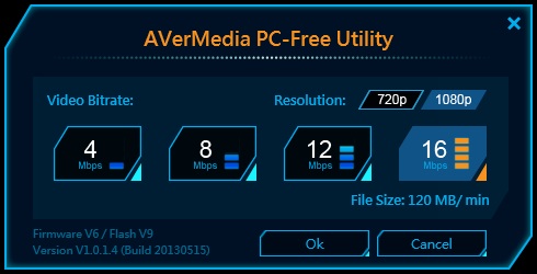

    Here's the settings screen for the avermedia live gamer portable which is used to set pc free mode.
    That looks promising. Can you get to that screen without a PC hooked up? If yes how do you make your selections?

  5. Originally Posted by zapster View Post
    Avermedia lists these resolutions and frame-rates for PC Free. The screen above does't show frame-rate, how is that set?

    You have to plug the ALGP to a pc via USB then set the recording option eithe 720p or 1080p and Bitrate, not sure what happens to the frame rate, I guess it just records at the framerate outputted from the device you're recording?
    Once the ALGP is set that's it you don't need to use a pc you just plug the USB Into a power source I.e. TV USB. There's loads of YouTube vids on the ALGP working in pc free mode.
