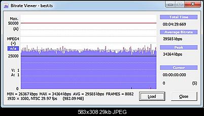

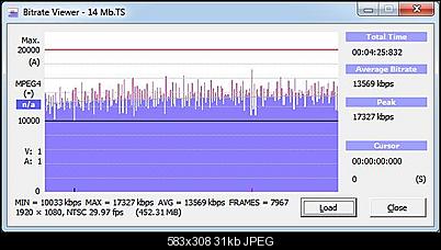

    No, the max the HD PVR puts out is 14 Mb/s, not 14 MB/s. From an HD PVR 2 cap:
    30 Mb/s from an Elgato HD Game Capture HD:

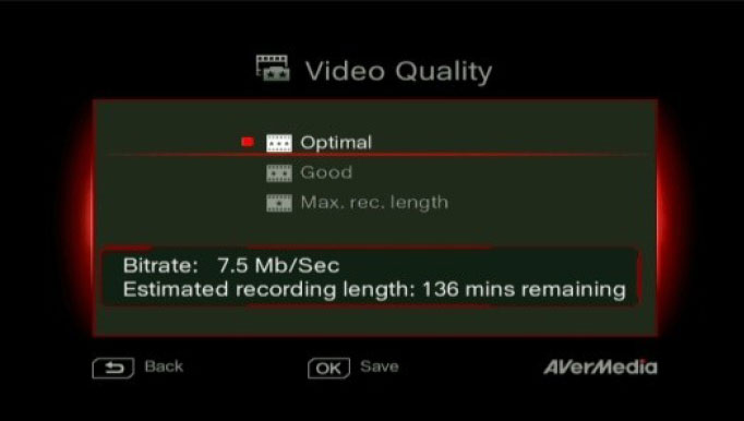

    This is the screenshot from the C285 user manual
    See Page English-13? it list all bitrate.

    May 2008
    so the manual has a conflict
    Anyone own this device to confirm which is correct?

    No there no conflict it say in the screenshot
    Mbps Kbps div max MB datarate
    7.5 7.500 8 0.8 with MAX of 20 20000 8 2.4 unlike the c875 which lists a much higher bitrate
