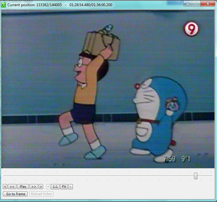

    I need an script for this video captured of TV (you can see in attached files).
    I'm in Megui. What's script I need? (For the colour space problem you can see in the walls)
Name:	Sin título.png

    What colorspace was the original video? How was it "captured of TV"? Recorded on a VCR? Recorded on a DVD player? Recorded on tape and captured to your computer? How much processing was done to the capture?
    If you don't know how to make unprocessed frame captures from a video, or don 't know how to cut a short sample of video to submit to the forum, you're welcome to ask. There's no way anyone can advise you from a single frame as seen in a processing window.

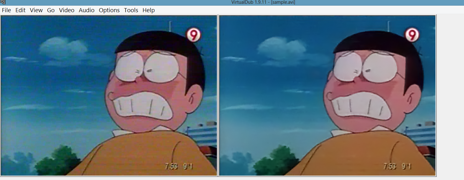

    I used only Vdub ( MSU smart deblock, Neat video, Camcorder color denoise)

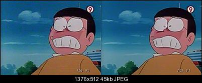

  6. Try the VHS filter in VirtualDub. Or CNR2() in AviSynth. Or even McTemporalDenoise() if you can stand how slow it is. But a poorly deinterlaced Xvid encode of a low bitrate MPG file of an NTSC/PAL conversion of a VHS tape is a bad starting point. Before and after McTemporalDenoise():
