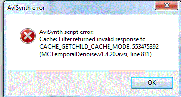

Hi jagabo, I already did this but unfortunately this is the error I get:
I used this MCTemporalDenoise script: http://avisynth.org/mediawiki/MCTemporalDenoise -
I don't know why, but the latest AviSynth build seems to require an explicit call to SetMtMode() when using some filters -- like QTGMC(). Just add a SetMtMode() to the start of your script. Or supply the arguments for the mode and number of threads (as in the sample I posted earlier). The number of threads should be set to at least the number of cores your CPU has. I usually set it to 1.5x the number of cores (I have a quad core CPU so I set it to 6) for maximum performance.
