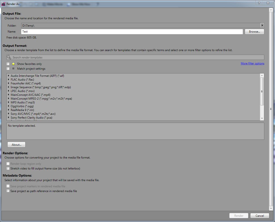

    Would really appreciate if someone could help me understand how to save/render or whatever you like to call it an output file from VMS. If possible I would be very happy if I could choose the xvid codec I normally use in VirtualDub which gives both great IQ and a reasonable filesize.

    When you select the 'Render As' from the project menu, you click on 'custom' and that should allow you to select whatever codec you want to render the file.

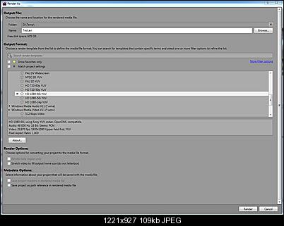

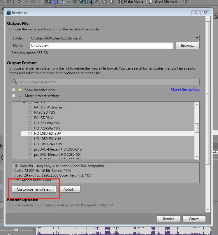

  16. Problem is I don't have a custom button to click on, this is what it looks like after I clicked Render As... under the Project menu
    //Richard
  17. You have to choose a preset in order for the custom option to become available.
    Tick the match project settings box and see if anything comes up with an mp4 option,
    otherwise try one of the sony avc/mvc presets.
    If you choose an option with video for windows (avi) and custom settings you can actually use xvid, assuming its installed in your system.

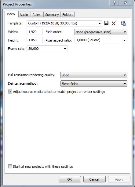

    @smrpix - Thanks for your input and tips! I've tried what you suggested but regardless what render template I choose I don't get that custom button showing up so something clearly must be wrong here and I'm pretty sure it's my lacking knowledge about VMS.
    First of all, looking at the project properties what settings in there are important for me to check? This is what it currently looks like
    [Attachment 18458 - Click to enlarge]
    Checking the properties of one of the 3 FRAPS files I'm working with under the Explorer tab in VMS this is what it says:

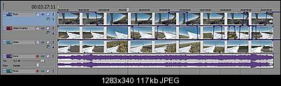

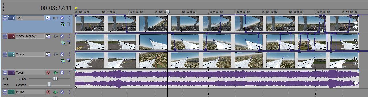

    This is what my timeline looks like in VMS and as you can see to accomplish what I wanted in the first place and the main reason for trying VMS out I have inserted a composite level envelope for all 3 video tracks to be able to alternate between them during replay following the tip on this I found here -> http://www.youtube.com/watch?v=I1VkY6v3Ll4
Name:	VMS timeline.JPG
    So...now I just need to understand how to save my output from VMS and I'm home free

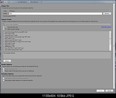

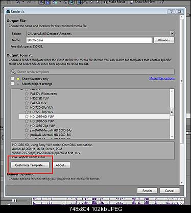

  23. Vegas may not export to fraps -- although if it does it will be under the video for windows (avi) options. Forget about match project settings for now.
    You want your export window to look something like this, you have to select a template (any template) in order to customize it:
    Also FWIW, I find it faster to "add edits" rather than use envelopes -- but that's just two different ways of skinning the cat.
    You've already come far from where this thread started. Well done.

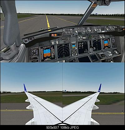

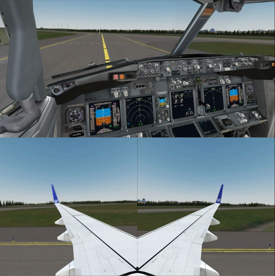

    Maybe a short resumé would be in place to better understand what I'm trying to do here.
    First of all the input clips are screen captures in different views from a flight segment in Microsoft Flight Simulator X and the captures are made by FRAPS. One clip from a cockpit perspective and the other two clips looking out over the left and right wings from a passenger's perspective. My initial plan was to use a "split-view/PiP" approach like this...
Name:	Split screen content.JPG

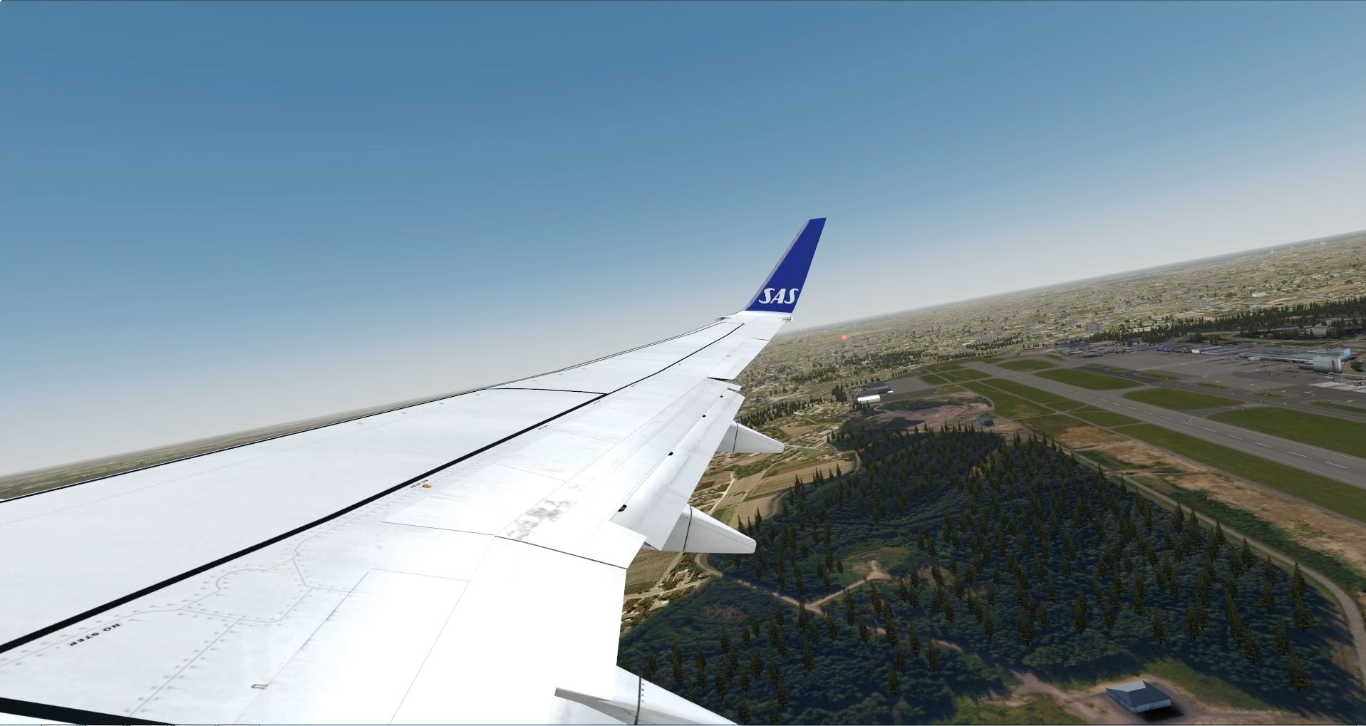

    ...which I was able to accomplish by using an AviSynth script and feeding the script to VirtualDub but I later realized much of the immersion factor went away having the different perspectives stacked together like this rather than watching each one of them in full-screen mode like this...
Name:	Wing view right.JPG
    ...so that's when I got the idea maybe I could find a way to alternate between them while playing them back instead. I figured using that approach would both let me watch the replay of the flight from all perspectives but at the same time keep the immersion factor watching them in full-screen mode.
    As already said above I couldn't figure out how to accomplish this using AviSynth scripts so that's why I started looking for another way of doing it and ended up with Vegas and I was especially thrilled when I found that YouTube clip I linked earlier since that clip spot on showed the effect I was looking for.

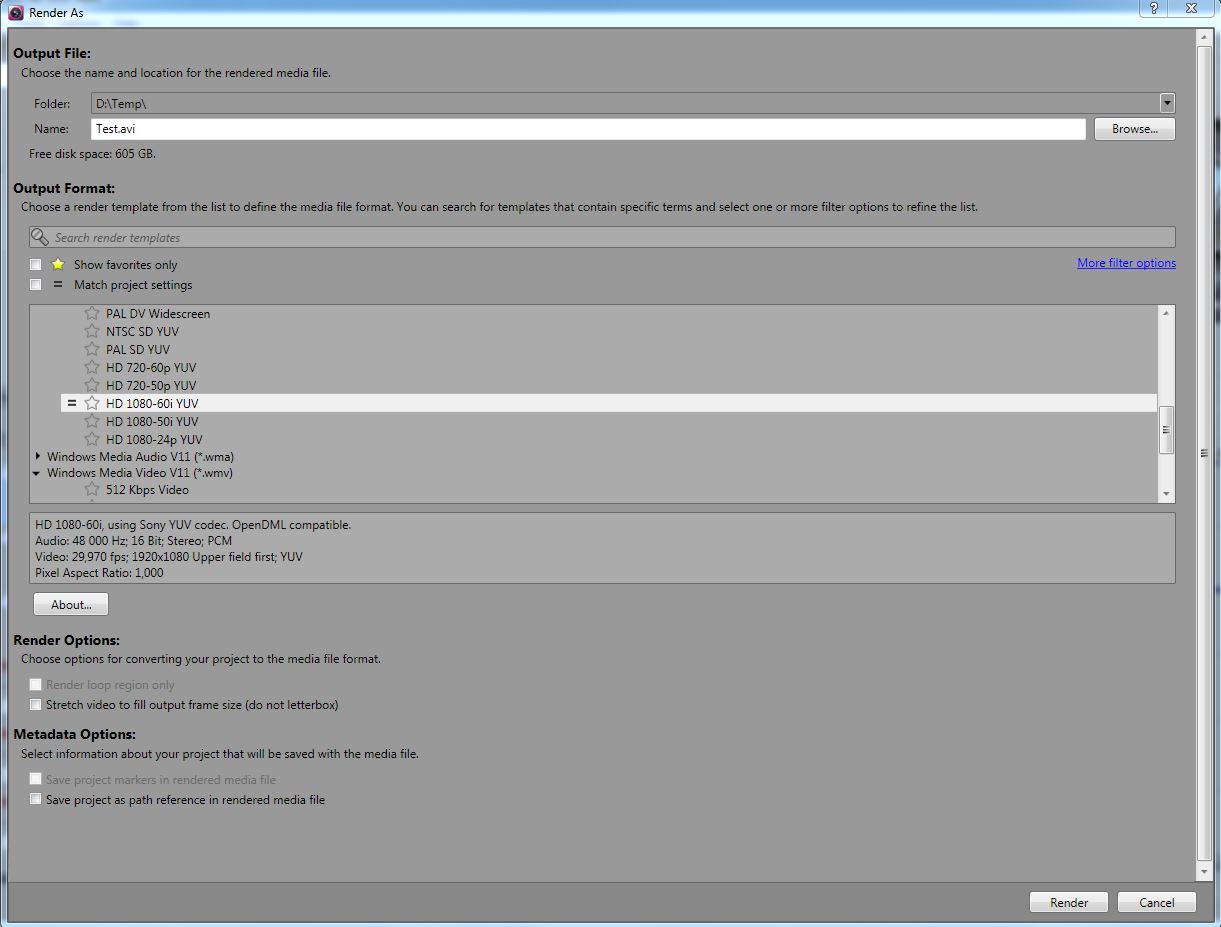

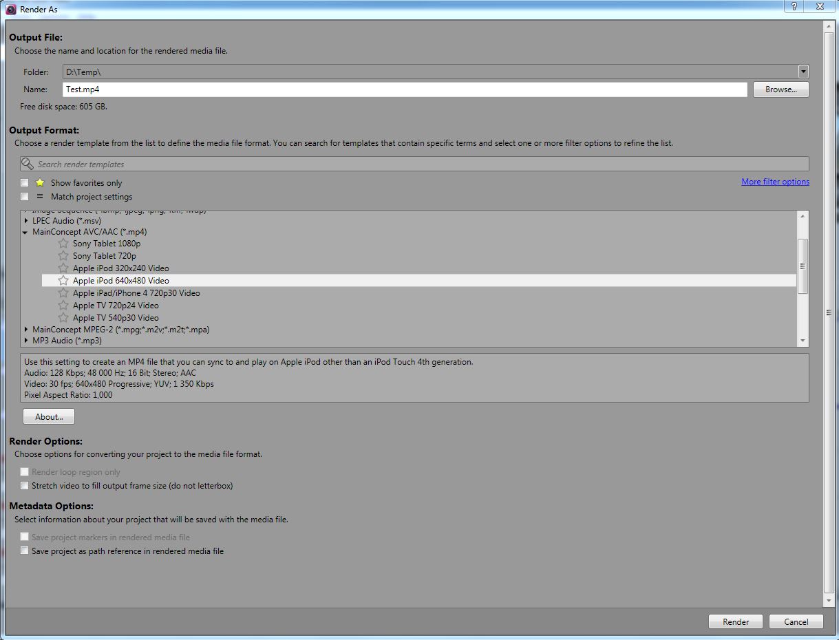

    I understand I need to first select a template to be able to customize it but problem is as seen here that despite selecting a template in the list (and I think I've tried them all but using the same one as you in this example...) I never get this 'Customize Template...'-button
Name:	VMS output formats with one format selected.JPG
    I did learn one more thing though since my last post

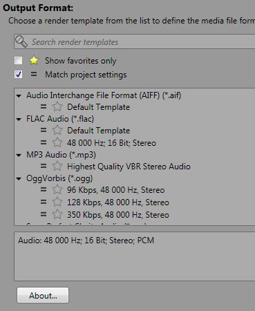

    Reason I only had audio templates to choose from in my list when checking 'Match project settings' in the Render as... dialog was that I had pressed the 'Match Media Settings' button on the Video tab in the Project properties window and then pointing out one of the 3 input clips in FRAPS format thinking that would help Vegas understand the input format. However that didn't do any good but instead resulted in only showing audio templates in the Render As dialog. When selecting one of the pre-defined profiles under Project Properties (in this case HD 1080-60i (1920x1080; 29,970 fps)) I have now both video and audio templates to choose from in the list again.
    So...that brings us back to my main concern at this moment...why don't I get to see this Customize Template button so I can choose my own output format like Xvid, H.264 or a similar format that will give me both a descent filesize and quality.
    Do you think the problem could be that I'm running the Trial version and this is some kind of limitation that you can't customize your own output formats in this version? I will definitely buy Vegas but before doing so obviously I want to see it will let me do what I want.

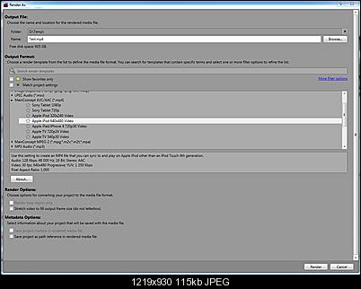

    No problem, just felt what you wrote didn't sound much helpful nor friendly but maybe it was me reading what you wrote in the wrong way. Good we have it sorted anyway!
    As you can read in my reply to smrpix it doesn't matter if I select a template, I still don't get this Customize Template button. As for trying the H.264 codec in Vegas this is what the list look like here when choosing the AVC/AAC category and also in this screenshot I have selected one of the templates as you can see but still no Customize Template button so I more and more start to think this is some kind of limitation in the Trial version I'm running. Very annoying if that indeed is the case because I won't be able to test what I want to before buying the product...
Name:	VMS AVC AAC.JPG

    I would not have thought that the trial version is limited in this way. But there is also a 'Suite' version. What version does our friend use ?
    Unfortunately, I can not try this version(12) myself since by OS is almost as old as The Ark (XP).
    Do you have a 'Video For Windows.avi' selection ?.

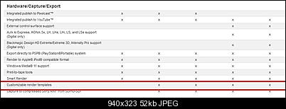

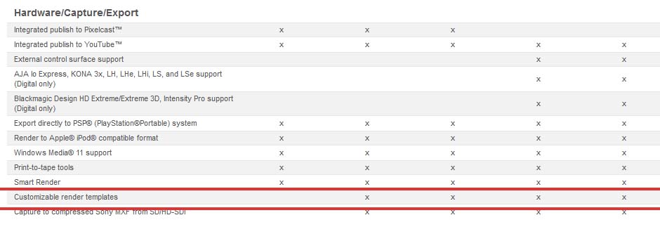

  28. Yeah, looks like you have to go to platinum. I'm surprised. Can you finish this within the trial period?

    Just wondering if I would be allowed to download and use that version in Trial mode as well now that I'm already running this version in Trial. Obviously I would then first uninstall this version but when checking the About-box in this version I see it's already registered to me and I also seem to have got a temporary serial nr and a machine ID.
    Yes, I do have a Video For Windows section with lots of templates as seen in these 2 screenshots but again no matter which one I pick I don't get to see the Customize Template button and I'm not sure if any of these preset templates would be equal to using the Xvid or H.264 codecs I usually use when working in VirtualDub? I have tried some of these preset templates. For instance I tried the one marked as matching the project properties called HD 1080-60i YUV with a very short test clip also made by FRAPS. The duration of the clip is only 7 seconds but yet the output using this template in Vegas was nearly 1 GB and it would only play the audio and not the video using WMP so guess it's using some special codecs I don't have on my PC.
    Name:  VMS Video for Windows pic1.JPG
    Name:  VMS Video for Windows pic2.JPG
    Too bad really such a simple thing as saving your output file in a "normal" format should be so hard when I finally found a program that would let me mix my clips the way I wanted...sigh...
