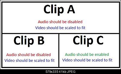

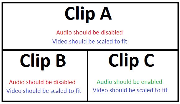

    I have 3 movie clips made by FRAPS. What I would like to do is to compress them using VirtualDub with the codec mentioned above and to have the 3 movie clips combined into the same screen so the output will show all 3 movie clips playing simultaneously - one at the upper half of the screen from side to side and the other two side-by-side at the bottom half of the screen. Also I would like the clips to be automatically re-scaled to fit and last I only want the output to include the audio from one of the clips at the lower half of the screen.
    I made a very simple drawing trying to illustrate this
Name:	Split screen setup.JPG
    Thanks in advance for any tips on how to accomplish this using VirtualDub together with AviSynth scrips.
  2. Originally Posted by WebMaximus View Post
    You can tell just by looking at the picture that the width x height ratios aren't the same for A .vs B and C. Maybe before resizing them you'll be cropping from the top and/or bottom of A? Or from the sides of both B and C?
    The audio issue is simple. Just add in the audio you want during reencoding or muxing. As for combining them all, simple as well:
    A=AVISource("Clip A.avi",Audio=False)#Disables the audio, if it has any
    B=AVISource("Clip B.avi",Audio=False)#Disables the audio, if it has any)
    C=AVISource("Clip C.avi")
    D=StackHorizontal(B,C)
    StackVertical(A,D)
    This can all be done in one line (I think), but I've divided it into five to make it easier to understand
    You could also add little black borders between the videos with the AddBorders command. Most of what you're asking is pretty simple in AviSynth. The tricky part would be to get the three clips at the right aspect ratio, in my opinion.

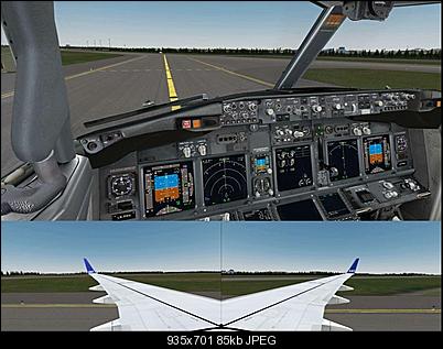

    However like you warned me about the AR of clip B and C was messed up and both clip B and C looked very strange and compressed so I have now started to re-think how I could combine all clips into one single movie but at the same time keep the original size and aspect ratio. One idea I came up with and I'm not sure if it's possible to put into practice using a AviSynth script would be to instead of showing all clips at the screen at the same time instead alternate between them every 10 seconds for example.
    Say I'm having clip A, B and C like in my original example and when I start the movie I'll see clip A for 10 seconds between 00:00-00:10, then a nice transition effect switches to clip B for 10 seconds before transitioning to clip C at 00:20 and then back to clip A again at 00:30 and so on. Important of course is that all three clips need to be playing "in the background" all the time even when they are not "in focus" sort of speak so the time sync between them is kept and they don't fall behind so in this example when the transition is made back to clip A from clip C at 00:30 clip A now also need to be at 00:30 and not at 00:10 from when the transition was made from A to B.
    Do you guys think this would be possible?

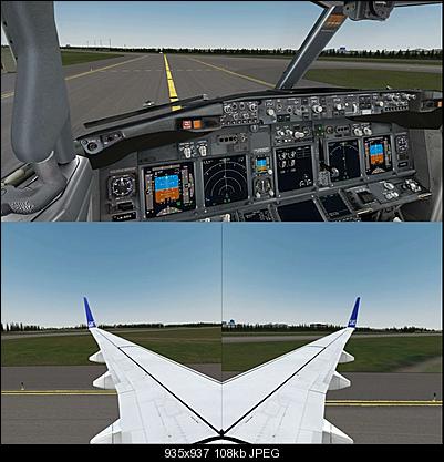

    Just realized I haven't wrote anything about the actual content of the clips and maybe doing that will make everything more clear. What I'm trying to do is to "re-create" a segment of a flight in Microsoft Flight Simulator X where clip A in my drawing above represents the cockpit view and clip B and C represent left and right views over the wings.
    Here is a screenshot what it looks like and in this screenshot I used the script below but as you can see (although not as clearly as when actually watching the running movie) is how compressed the wing views look.
    A=AVISource("A.avi",
    false)
    B=AVISource("B.avi").BilinearResize(960,1080)
    C=AVISource("C.avi",
    false).BilinearResize(960,1080)
    StackVertical(A,D)

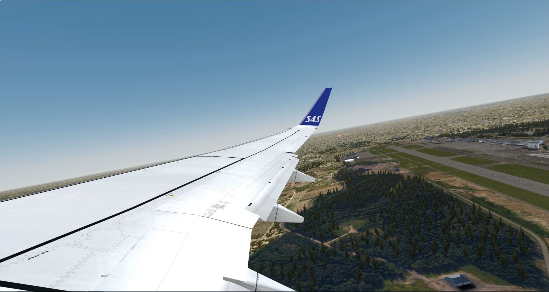

    This is what the wing views look like in their original format, a HUGE difference from the split view above as you can see.
Name:	Wing view right.JPG

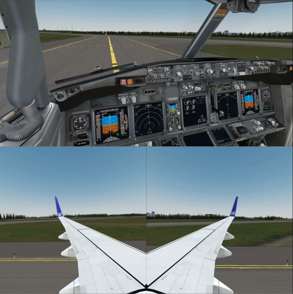

  18. So do what I suggested -- resize both the width and height of the small frames keeping the AR.
