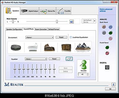

  7. You might find a graphic equalizer in the sound card's setup applet. For example, with RealTek drivers:
    From what I've seen of your videos they typically have VHS hiss. Turn down the 4K and higher bands.
