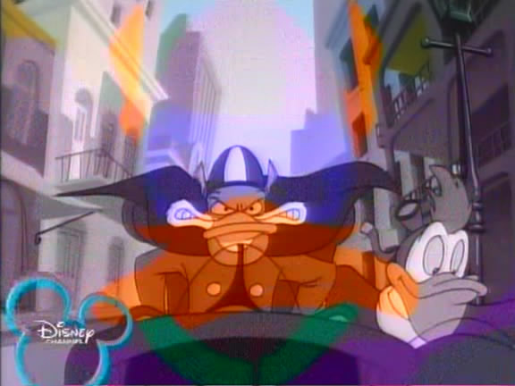

    As the video plays first comes this frame:
Name:	Darkwing.Duck.E34.Kikis.fliegendes.Geschichtsbuch.avi_snapshot_00.01_[2013.06.18_19.29.34].jpg
    As you can see in this first frame the colour of the next frame is shown, while the characters appear colourless!!!

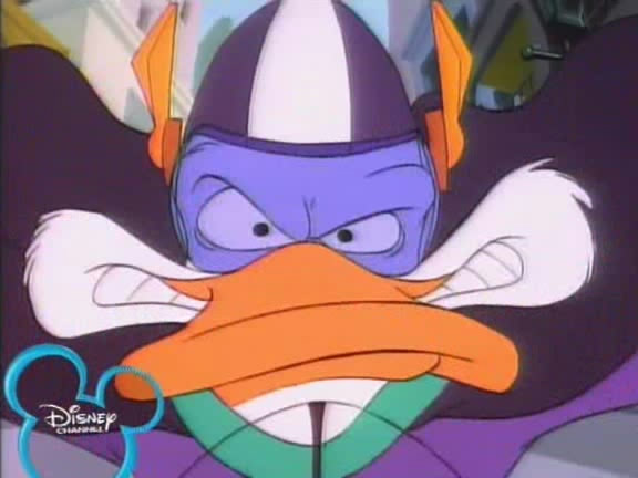

    After this first frame comes this second frame:
Name:	Darkwing.Duck.E34.Kikis.fliegendes.Geschichtsbuch.avi_snapshot_00.02_[2013.06.18_19.29.57].jpg
    As you can see the colour of the character here appears to be synchronized, but in fact it's still ahead of the picture (because the movement of this part of the video is not very fast. In other quick movements the colour remains shown ahead of the picture untill the quick movement slows down)

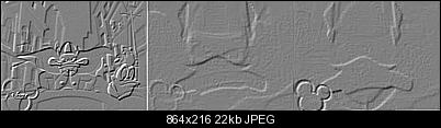

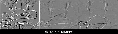

  5. Yes, I couldn't see any obvious pattern to the frames with the problem either. You can use MergeChroma(Trim(1,0), last) to fix the frames with the problem but it creates the problem on frames that don't have it. I wonder if there's a way one could compare the chroma channels to the luma channel and see how well the edges line up. Then use that to decide whether to keep the original frame or the fixed frame.
    Y, U, and V stacked horizontally and embossed, which is a better match:
