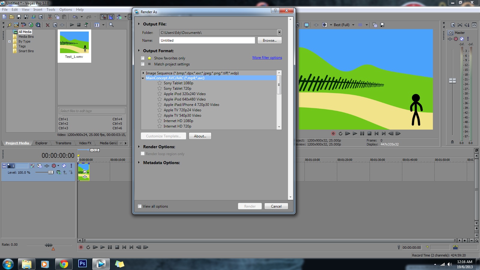

    In addition, the profile is main@L3.2 which is limited to 1280x720p60 .
    Can you pinpoint me how to set up the profile? Here's a screenshot of the option availabe.
    Thanks guys for replying.

  16. Vegas allows 60p export, it sets level 4.2 automatically if it is 60p.
    You have to find template where you can change fps to 60, like "Internet HD" first you have to change profile to High, and then type 60 or 59.94 in there for fps, whatever you have . That goes for MainConcept avc. You cannot choose Blu-Ray obviously, because Blu-Ray does not allow full HD 60p.
    As for Sony avc export, you try some Memory stick export and customize it, first you have to change video format to "avc", change "frame size", profile to high, frame rate to 60p or 59.94 whatever you have. Again, you cannot choose avchd for example and try to modify it because there is no avc option there.
  17. At last! It worked!!! It seems the main problem is the wmv video. Yeah, it does runs smooth as 60 fps, but when it is checked in the media properties, it still stated that it has 25 fps.
    So, I've tried to change it to other format, some of them changed their fps to 25 eventhough I set it to be 60, and some of the did maintain its 60 fps, but they are not acceptable in Vegas.
    But at last, the mp4 avc format in xilisoft did the job. After the conversion, it still maintain its 60 fps, and Vegas can open the file too.
    And after I customize the template, with the recommendation from you guys, the rendered video runs smoothly!! With the 60 fps!!
    Thank you so much for the help guys!! Really appreciate it!
