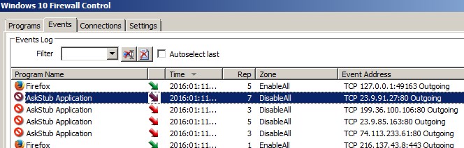

  21. Video Restorer lordsmurf's Avatar
    @Baldrick:
    Here's what happens on 2.5.7.0
    When the Imgburn installer launches, it puts all the install files in your temp directory. The Ask Stub is put there too, but it's just the installer. For now, it's benign. It does almost nothing. It's waiting. It's just like any other stub, be it Firefox or Adobe Flash. Remember that the stub isn't the full program.
    C:\users\ls\appdata\local\temp\apnstub.exe
    When you go to install 2.5.7.0, simply uncheck the Ask Toolbar install option.
    When the temp folder is emptied at some point, the never-did-anything installer (including all the Imgburn files) are wiped out.
    Ask Stub does try to connect 4 IPs:
    [Attachment 35192 - Click to enlarge]
    However, this is likely for the purpose of connecting to Ask, as part of the prep for install. Again, a stub is not the full software. The stub downloads the current version of the full software. But if no install is made, it does little more than tell Ask that an install attempt was made.
    I use Windows 10 Firewall Control from Sphinx (freeware version), which essentially turns the Windows firewall into Little Snitch (a popular Mac tool). It has nothing to do with Windows 10, so don't be fooled by the (stupid) name. HOSTS file adds are not as needed when running this, as you can wholesale deny a program any network access. For example, I tell my Adobe software to STFU and sit in the corner. All the constant network access was ridiculous.
    So 2.5.7.0 is safe. It's version 2.5.8.0 that had all the auto-install shit.
    In those earlier years, changes to Imgburn were more meaningful. So version 2.4.x is far too old, and even version 2.5.0.0 may be a bit lacking. But 2.5.7.0 was essentially the final version, with 2.5.8.0 only adding crapware. So if you only give download links to older version, you may need to warn others that features may be missing.
    See also: http://www.imgburn.com/?act=changelog
    I would not bother installing anything older than 2.5.5.0.
