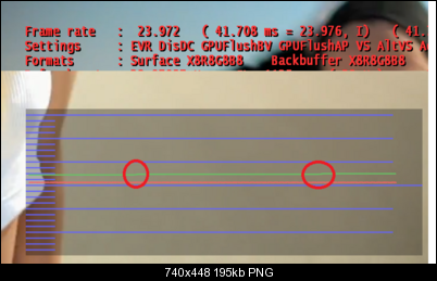

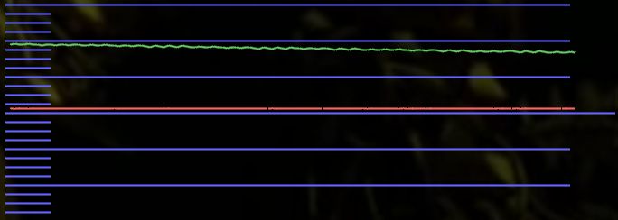

  14. 23.972 instead of real 23.976 (NTSC 24p/23Hz) you can see that sync is drifting away and must be synced (-> drop or double a frame) but in 50Hz mode this isn't the case. You can't compare that two things.
    Here you can see the little the steps I don't want to have in 23.976
    To avoid that and also needing a second computer this year I think getting a Haswell with hopefully perfect 23.976 refresh rate handling would be a great thing. But that needs to be tested in detail when I have one.

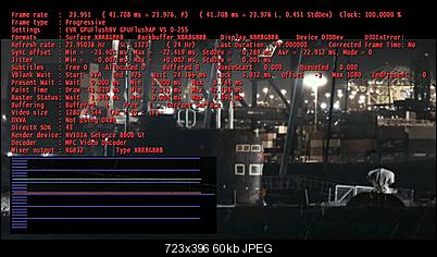

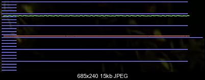

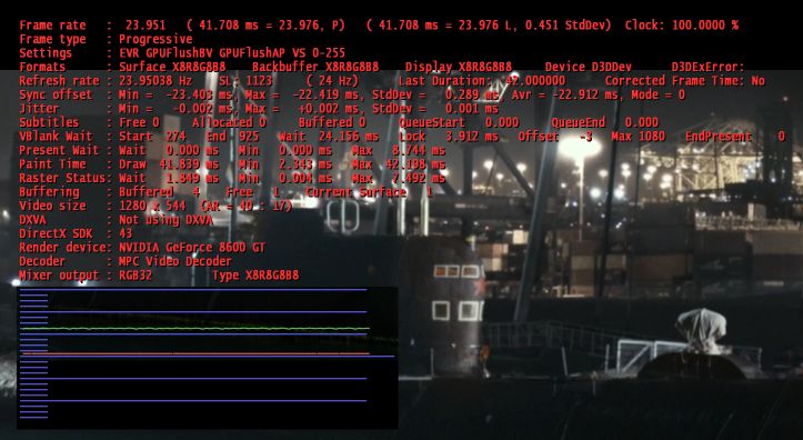

    If these mean more to you than they do to me, below are a couple of screenshots using a refresh rate of 24Hz (real refresh rate 23.951) while playing a 23.976fps video. The first is without ReClock doing it's thing, the second with it.

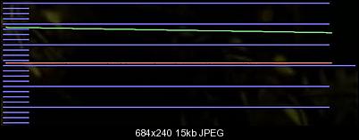

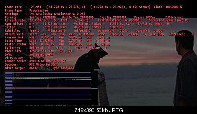

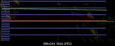

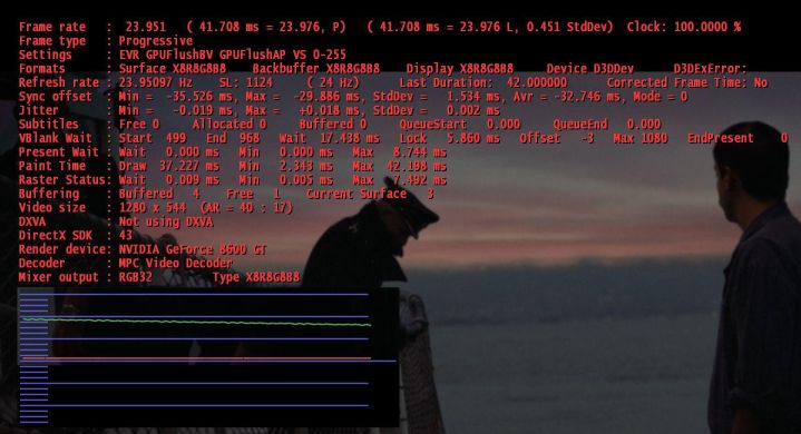

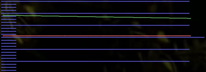

  16. As a side note, even the way the frame rate of the video is saved can make a slight difference. When remuxing video and setting the frame rate to 23.967, some programs round it to a single frame duration while some use slightly different frame durations in some sort of repeating pattern. For example VirtualDubMod uses a constant 41.708ms frame duration while I think VirtualDub uses 41.7083ms and 41.7084ms in a repeating 3:2 pattern (or something similar). MKVMergeGUI seems to use 41ms and 42ms frame durations in some sort of 3:2, 2:1 type pattern. I've also seen a constant 41.7084ms frame duration used, which some programs round to 23.976 while others round it to 23.975. And of course true 24fps video has a constant frame duration of 41.666666666667ms. which is "fudged" using similar methods.
    As an example, here's three screen shots. The same video each time. The first remuxed with VirtualDubMod while setting the frame rate to 23.976, the second remuxed with MKVMergeGUI. The third is the same as the second, except ReClock is being used. The TV refresh rate was 23.951Hz (24Hz).
