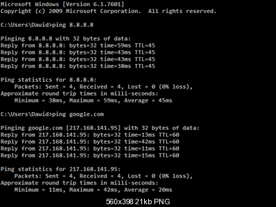

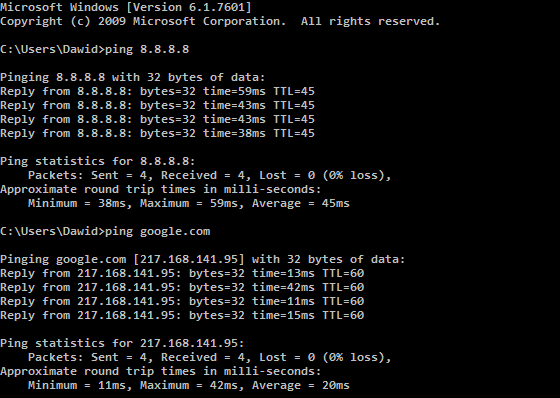

  2. open console (cmd.exe)
    enter ping 8.8.8.8 and hit enter
    if you get response then try ping google.com
    if you see error messages then there is something wrong with your DNS server. (Dead or incorrect IP)

    Both pings appeared to respong OK.
    Then you are on the internet.
    The fact that you mentioned that Windows Update works also proves this.
    You'll have to be specific about what exactly doesn't work, but internet connectivity is not your problem.

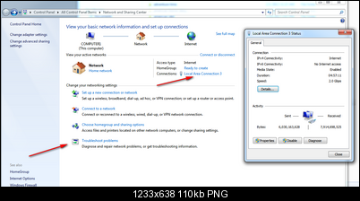

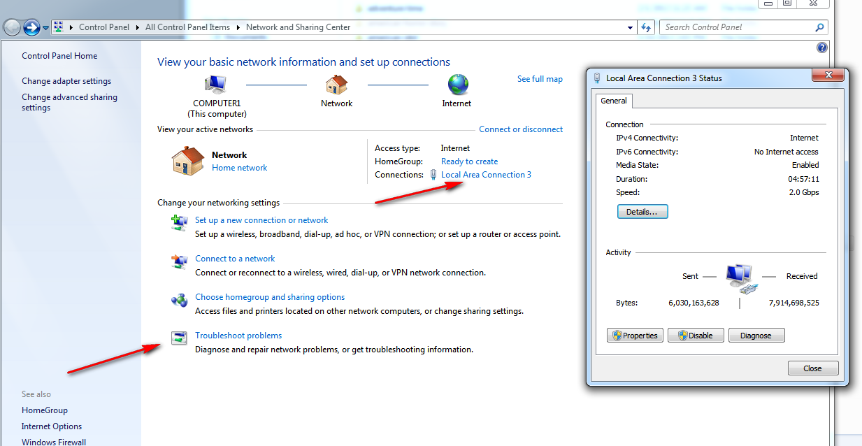

    if you go to control panel/network and sharing center what shows up? there are properties you can check there and a troubleshooting app.

    Thanks aedipuss,
    All the troubleshooting routines report nothing wrong.

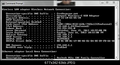

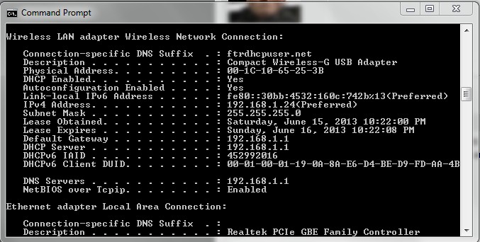

    Just a quick tidbit ... You might also type 'IPconfig /all' from the cmd window and see what your main network port says and if you have nameserver, etc. Should look something like this:

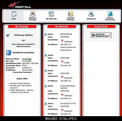

    This shows my address, 192.168.1.xx is a router and it is also my DHCP server and Gateway. If my connection acted as yours, I would also suspect this router/MOdem. If you also have a router, you can usually access it by its IPaddress and check or correct its settings. The display is different for different routers but the information is just in different locations.

    If you have a router (many people do) you might check this also. Many time service providers can help diagnose.

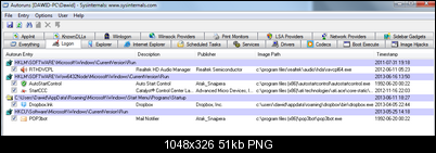

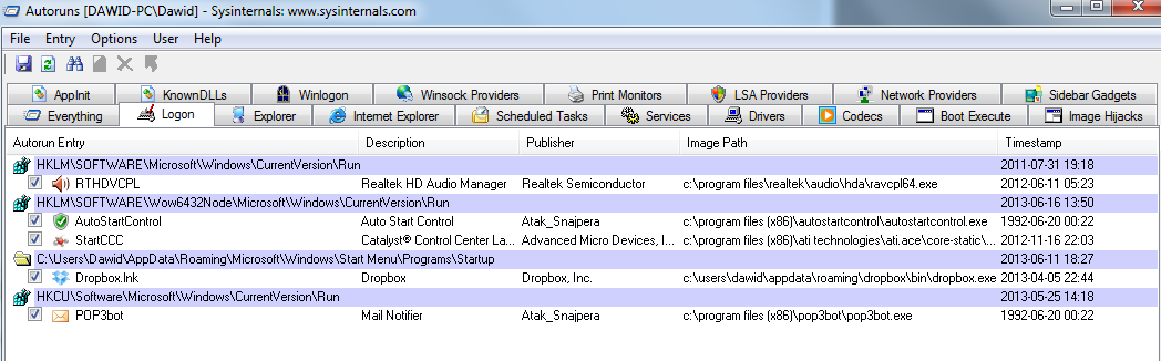

  22. Another idea.
    Download autoruns program from http://technet.microsoft.com/en-us/sysinternals/bb963902.aspx
    1) execute autoruns.exe
    2) in autoruns program click FILE -> RUN AS ADMINISTRATOR
    3) click on LOGON tab
    make a screenshot
    my example
